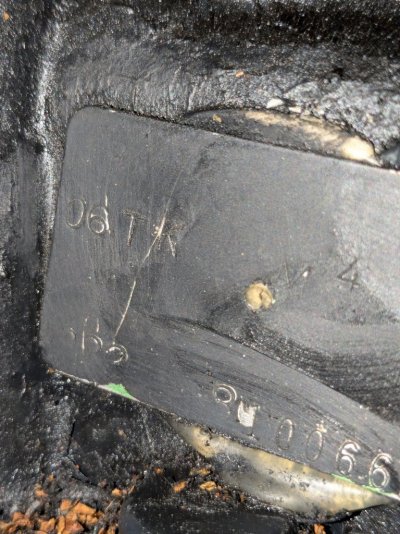

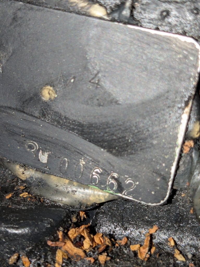

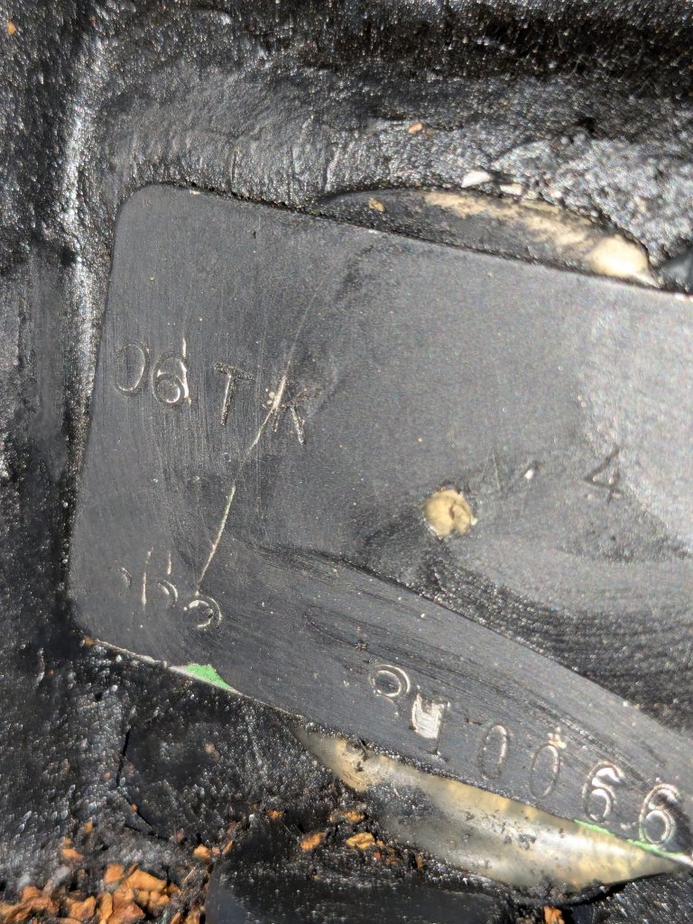

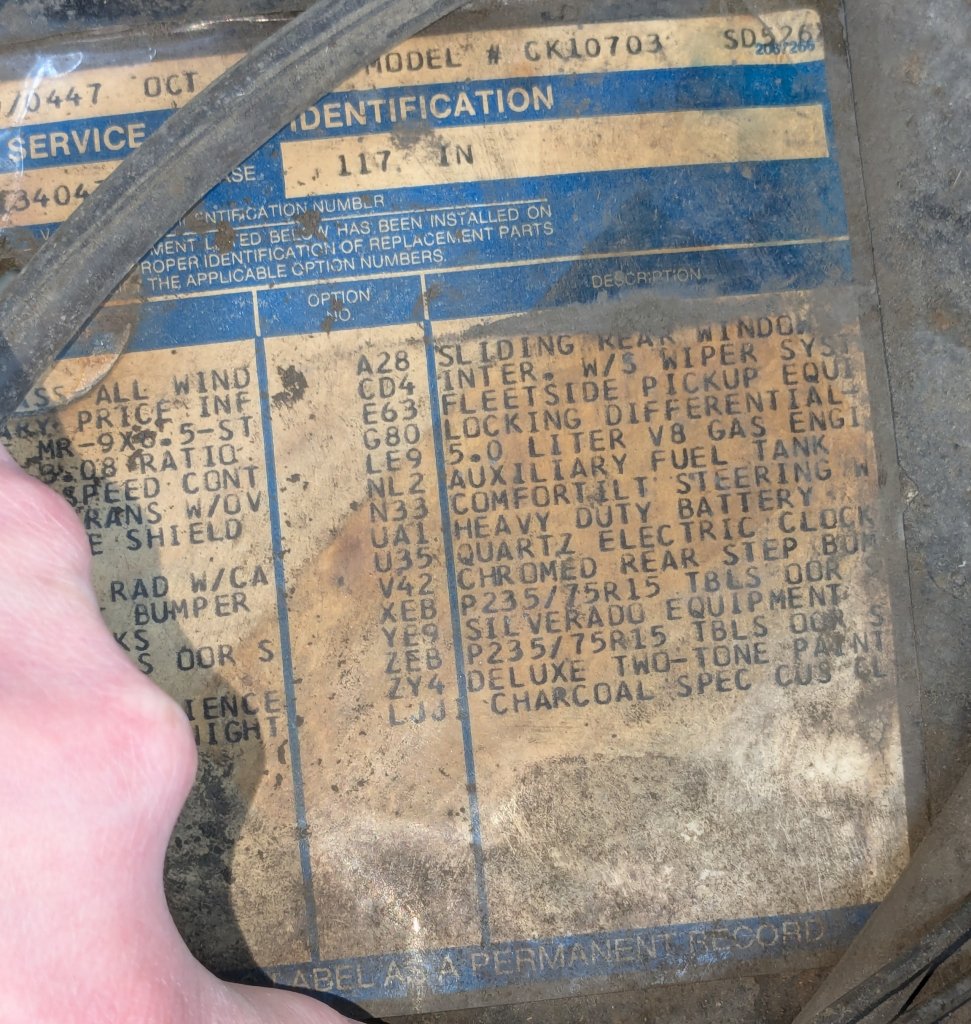

Hey I have a 700r4 that came stock with the truck, but I'm not positive that it's the original. I will post a picture of the ID tag hopping someone more well versed with these transmissions can tell me more info about it. The truck is a 1984 Chevrolet k10 Silverado short box, from the RPO the transmission is correct, the motor is now a 350. From what I've gathered so far this truck uses the TV cable for shift points and line pressure, it has the break pedal switch to take it out of lock up, and uses the tip in switch for... I want to say telling the computer that it's okay to go into lock up I think, not 100% positive tho.
I'm reaching out to see if someone can help me with the ID tag, and want your opinions on whether or not I should keep the stock transmission converter lock up set up or should I go with B&M or some other aftermarket kits to fully control the 700r4's shift points and TC lock up. My shift points are way to early doesn't kick down when it should and just giving me overall poor performance with the current setup. Would love to hear something advice or solutions to better improve the driveability and overall performance. Thank you!

Hard to make out that tag. Maybe my monitor, I don't know, but I can't make out most of it. If I had to guess, it may be an 86 transmission which means it's not the OE transmission. Just due to time, I'd guess that's it's not. 82-84 were the worst 700r4's and not even good cores. If you're looking for another core, try to find an 88 or later. 87 is doable too, but 88 and up have the most changes and updates and finally started getting a bit more relaible by that time.

A 700r4 should have the original partial vin stamping on the passenger side rear above the pan rail.
If it has a tag adhered to it that would, to me suggest its been replaced/rebuilt at some point.

Unfortunately it looks like someone took a grinder to it
It's very possilbe it was a factory reman unit. Most of those units failed they were so bad. So many got to go back to GM for warranty, some remanned with some fixes and then a sticker was put on them that's probably been washed or worn away by now. Those were so bad in 82-84, if the owner wanted it for the reliablity factor, GM was converting them back to Th350C transmissions which many times was just fine since many of those 1/2 ton trucks back then had 2.73 or 3.08 rear gears and didn't even need the OD. They may have even held up a bit better if GM would have ran 3.73's on the rear gears. The 700r4 was just junk. There was many changes made every year, after year and many parts were not backwards compatible, or if they were, you had to change other parts to support the changed part. By 87 and 88, they started getting better. The 88 and up also among many of the updates, has a tiny secondary valve body and why the 88 and up cores are the better ones to find and use for rebuilds.
