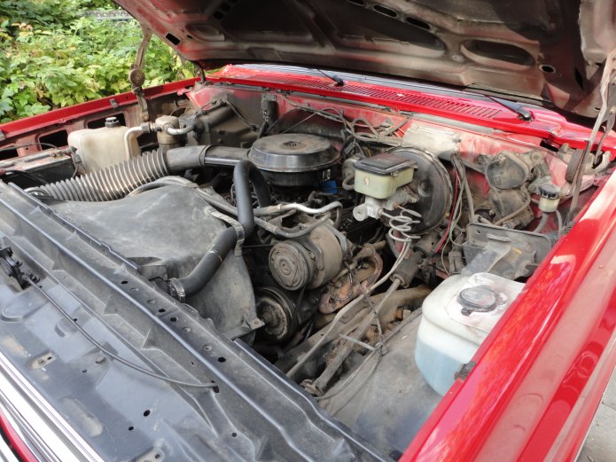

The port adjacent to the large portion of the reservoir is for the front disks; the smaller reservoir is for the drums.
If yours is like mine then front goes to the front; rear goes to the rear.

The one in the salvage is the opposite of yours, the rear port goes to the front and the front port goes to the rear. I checked a couple of other GM's with the same master and they all were plumbed the same way.
Nonetheless, this is still true no matter what.
The disks need the added volume to replenish the fluid due to wear, because of the size of the pistons (compared to the size of a wheel cylinder).
Port placement can be dictated by underhood clearance (moving the smaller reservoir to the front helps clear a highly sloping hood, like Astro/Safari van) or by features in the master cylinder, like quick take up or lack thereof.
