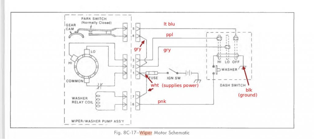

See attachment (wiper diagram labeled)- this is the basic setup on how the wipers work- white wire come from fuse box and supplies power. The switch is what adds a ground- depending which wire the switch grounds will cause different a speed or the washer. The pink wire is what the switch will ground to maker it spray. Some how the pink wire is getting grounded no matter the switch position.

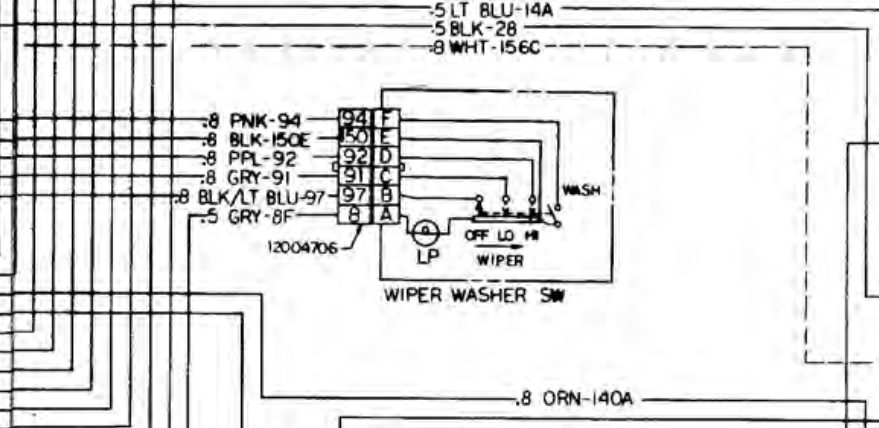

I would start by checking the connections- I included an attachment (wipers) so you can see the order the wires should be in connection to the switch.

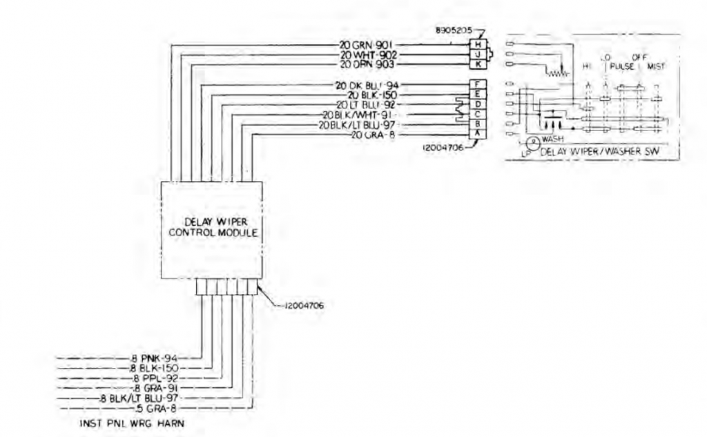

Another possibility is if you have a delayed wiper system and the module is shorted some how. _ see attachment (delay). In theory you can remove the delay module and plug the connectors together.
