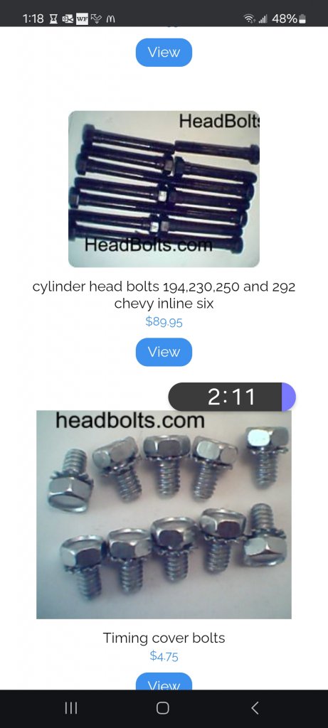

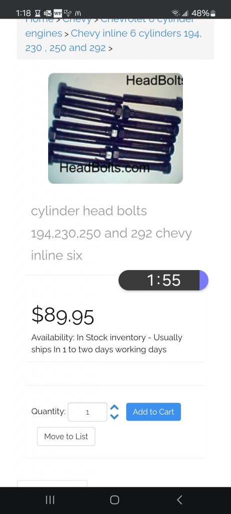

Found them. HeadBolts.com
from the site questions:
you are correct these head bolts will not fit your engine , integral intake manifold heads take different bolts and we do not have them at this time
Integral intake (head and intake manifold as one) is what I have, so...close, but no cigar.
