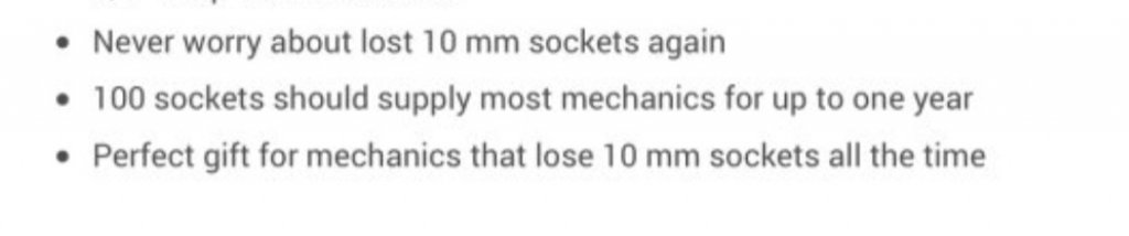

I zoomed in on part of there description lol
