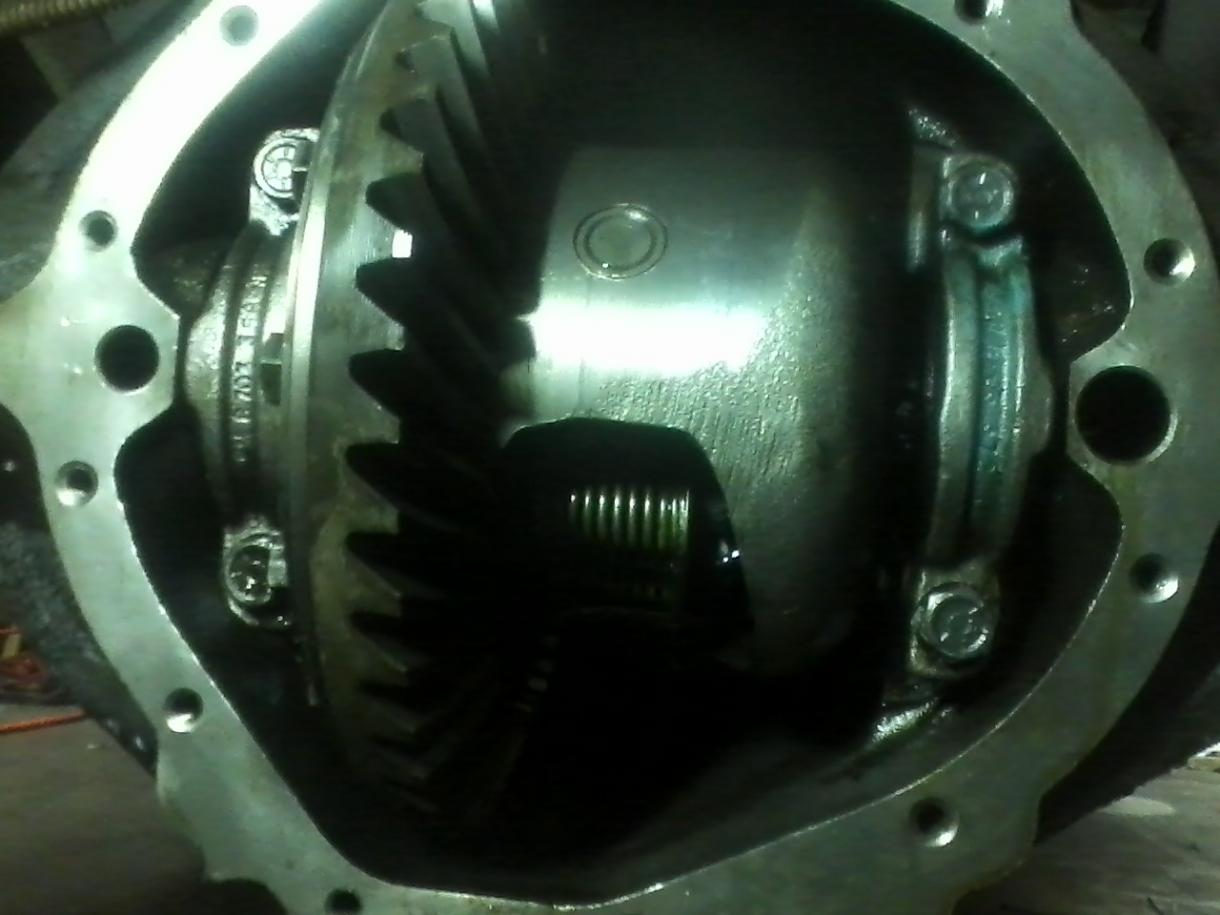

ok finally got the truck back in the garage here the rear diff

Not the greatest pic but just going by what I can see of that spring in the middle I would say you have a limited slip and should use the additive.
