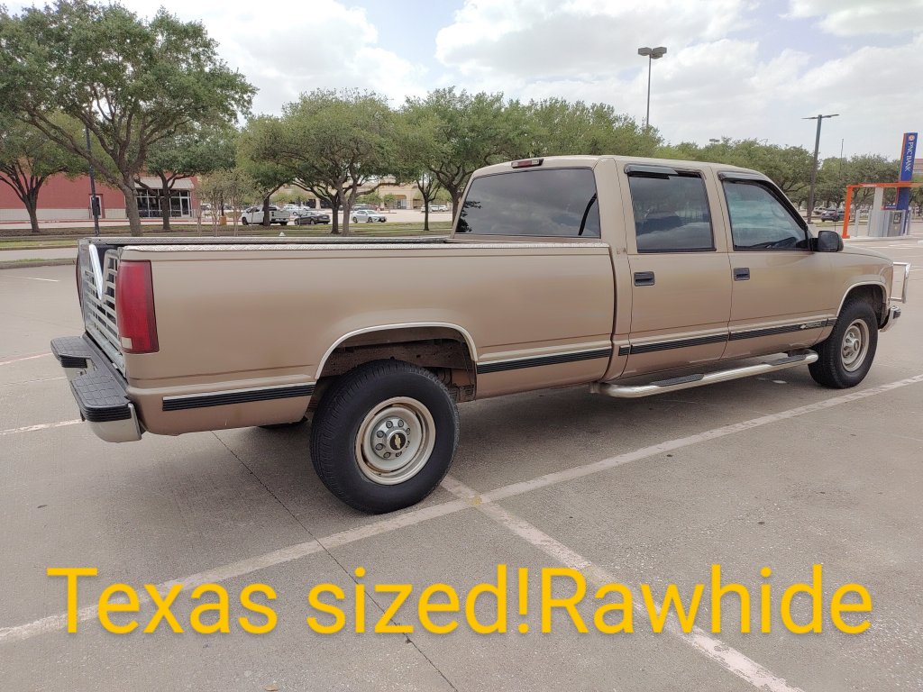

I think the later 8 lugs had a ,16" steel wheel like you're looking for. The OBS trucks have a steel 8 lug wheel but it uses a center cap and trim ring instead of the hubcap and trim ring.
Looks like this:

I think the dog dish 8 lug caps are the same size, early and later styles. But I'm sure someone will clarify or correct it if I'm wrong....but to use those, the wheel has to have the bumps on it. If it's smooth all around the middle like the OBS ones, the hubcaps will not fit! That's why they have the plastic center caps, that are held on by the plastic lug nut covers that thread onto the actual lug nuts.
