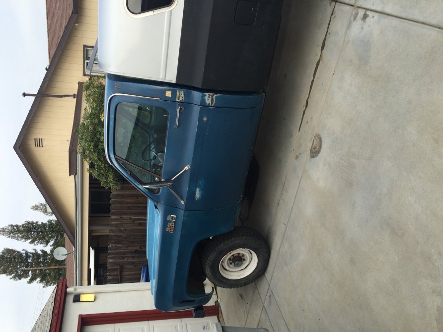

Thank you for the response and feedback. My friend's reasoning for needing the 17's was that the camper special had bigger brakes , hence needing a 17.0 nch rim. But I have found nothing online stating that.
I like the 16 inch rim look. I am an oldschool guy and 17's look good on tires over 35. I just dont like a 33 on the 17 rim - the ratio is wrong I am going for the stock tall/skinny mudder look.
I have attached a pick or two of my 79 Camper Special and a link to a photographer that snapped my trucks pic days before I bought it in LA. http://fotonomous.blogspot.com/2008/09/1979-gmc-sierra-grande-truck-polaroid.html
