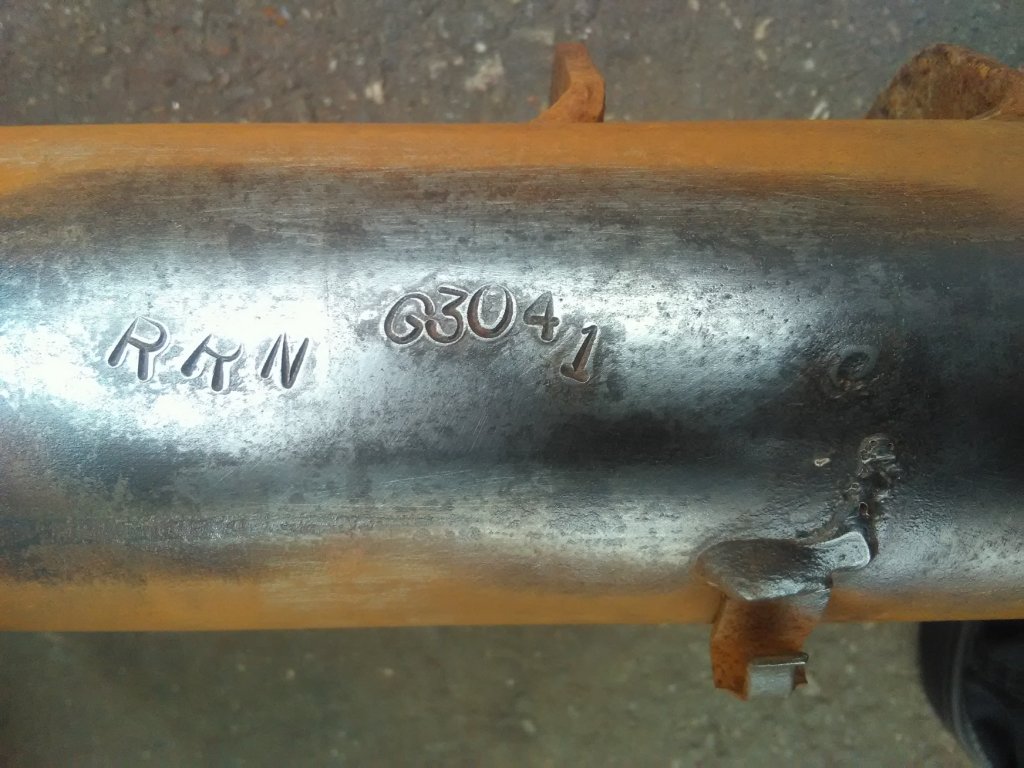

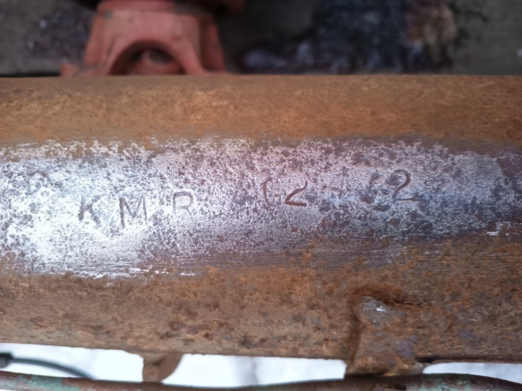

Hi been looking for info about codes stamped on the axle do any of you guys have that if and could post it
