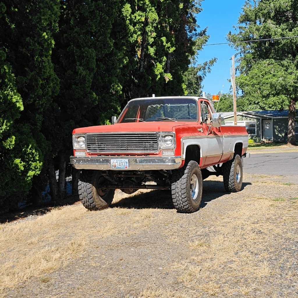

I’m looking for a setup like the picture below.
What wheel and tire size would you recommend for a 4” lift.

Those rims are probably only 8 inches wide, but have very little backspacing. Notice how much of the brake drum is visible.
Also with only 4 inches of lift, you're going to need rusty fenders to steer that, or trim the fenders if they aren't rusted away.

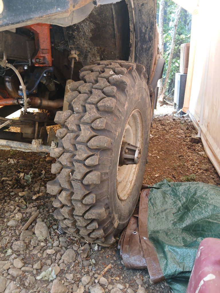

If you drive in the snow and mud get skinnys. I've haven't had much luck with wider tires for 4x4s.

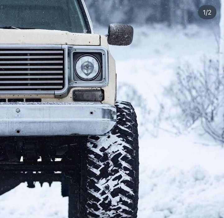

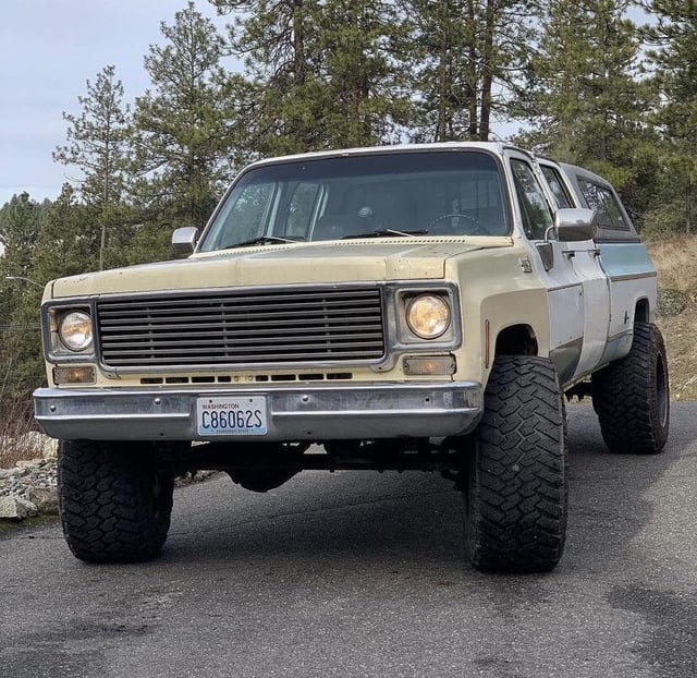

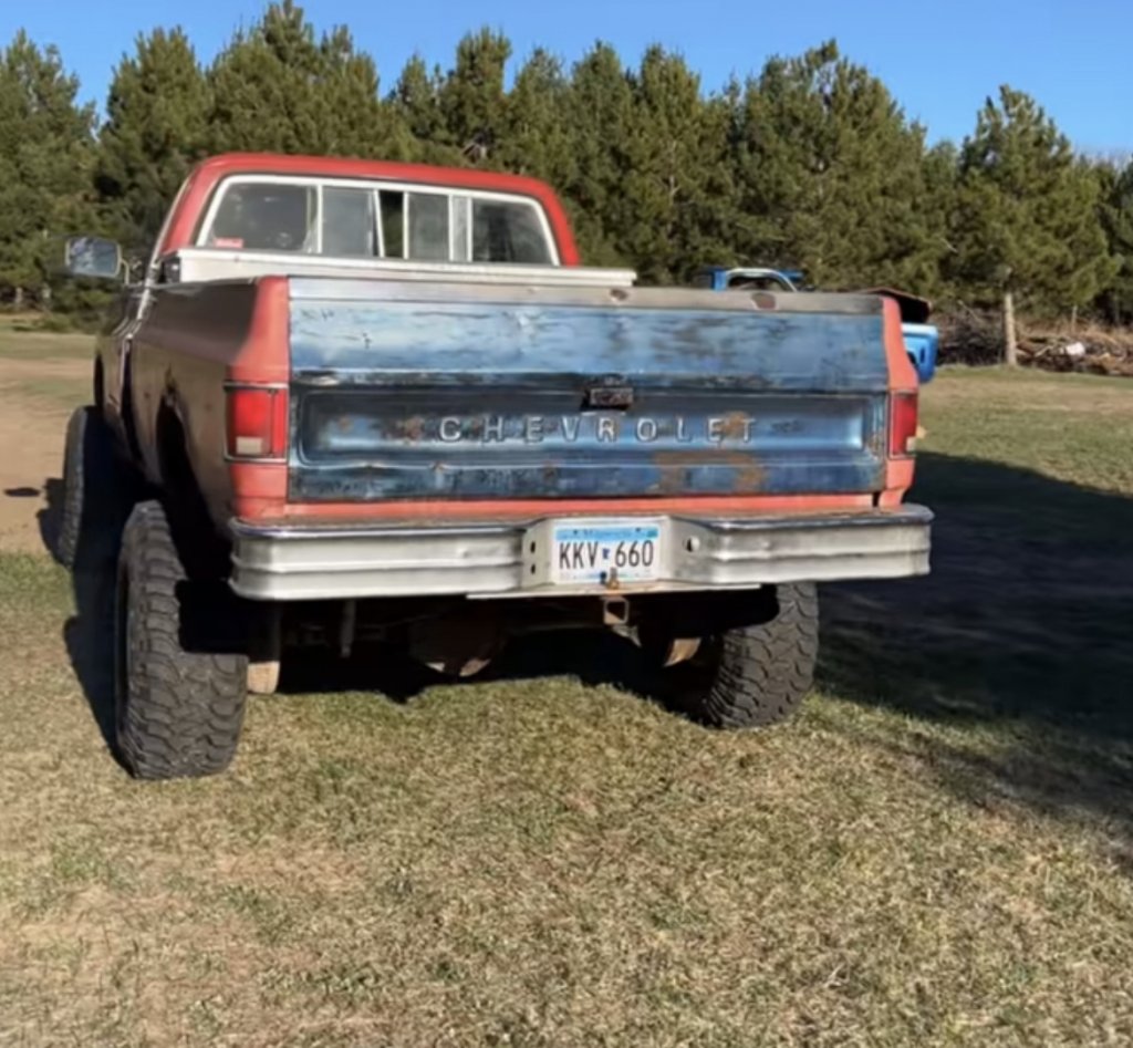

What kind of sizing would get some slight poke but not mall crawler maybe a happy medium between these.

The front ends poke with stock everything with rally wheels, so anything more dished or wider will poke a lot. The rears don't poke unless you've got wide wheels or spacers. Front compared to back axle track width is 3 inches, 1.5 inches on each side.
Ive never rubbed on 4 inch suspension and 1 inch body lift. 33x12.50 or 35x12.50 15's.
You'd be safe with 33's on a 4 inch on stock or similar spec wheels.
