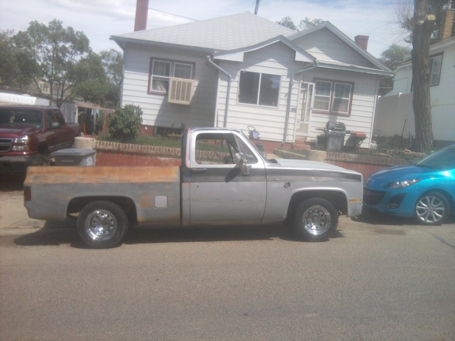

this is my 85 c10 axle flip rear home made 4'' shock extensions
front has 1.5 coils cut off only temporary want to go with 3'' spindles and 2'' coils when money allows.
295-50x15 rear 15x10 wheels rear
235-60x15 front 15x8 wheels front

I guess I should read the post first I thought you were asking for drop pics
your truck looks good I like the wheels
