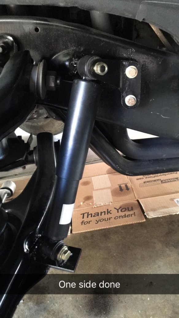

Can you post a picture of your setup?
With the reasonable drop you have, you should be perfectly fine with stock length shocks.
If your front drop was ALL spring, a shorter shock would be good.
What did you do out back? There are shock extenders for the back axle which are a good idea, but on mine I found I ~still~ needed a shorter shock (fully loaded, the bed sits on the pumpkin, and the shocks are fully bottomed) - I run 4WD ~front~ shocks on the back.

Out back I used a flip kit with the same shocks I have no issues with ride in the back just up front,I'm using nitro drop shocks for a 4-6 drop and they bottom out right when I lower the truck on the ground ,it's only coils and spindles up front no bags or anything crazy but they bottom out and I have no ride up front and it's trying to force the shock collar off of the rubber because it's not free and has no where to go

Looks like you need shorter shocks. Or your mounts are too close together. And no, shocks will not change your ride height, that's not how they work, they just dampen the movement of the suspension.

Shorter, so that at ride height it is not bottomed.
These were shocks I experimented with on a Nissan Hardbody I used to own:
It could be that you were sent the wrong shocks.

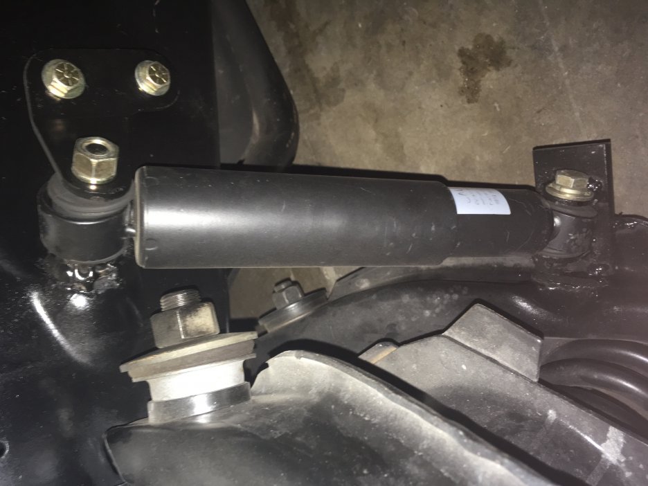

Really stock length? When I first encountered this issue it had happened on one side only and I had to buy a temporary shock until I ordered the matching one,when I put it on it was fully compressed also and this was before I got the shock supports. Idk if stock would be worth buying until I know it will for sure be the right length and give me some play to move,why do thy make different length shocks then for different drops?
This is how she sits

Why doesn't it look like the upper control arm busing is installed far enough.

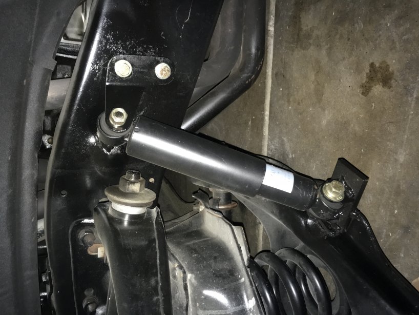

Well I did move the bottom mount from the stock location Just a bit but it's basically in the same area as u can see,so it is moved a bit so I'm wondering if this is why I'm having issues but I moved it for a reason because the stock location after I did all the lowering work was not running free and it was binding up and wearing the shocks out like right away literally and forcing the eyelet mount off the rubber after hitting a few bumps so I moved them to make them run more free and I'm still having issues
