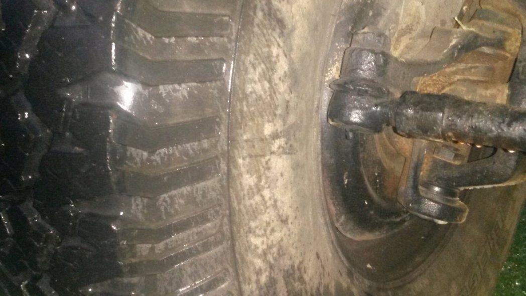

I cant even fit a pinky finger between mine with the 1/2 ton axles. Here are both of mine.

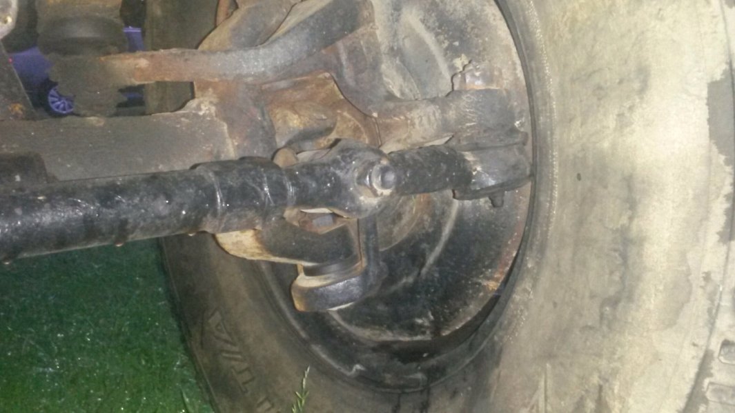

This is the drivers side

That's pretty close but the wheels you want might work. They will be 1/4" closer but you'll gain 1/2" on the diameter with the 16's. Are you buying locally or online? A local shop would be happy to set a rim on there to check the fit if they think it means a sale.

that looks like only a quarter clearance, not 1 inch... bahahaha:party36:

3/4 ton axles have a wider track, so there will be more tie rod clearance.
