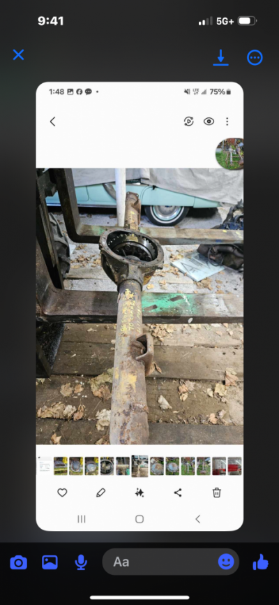

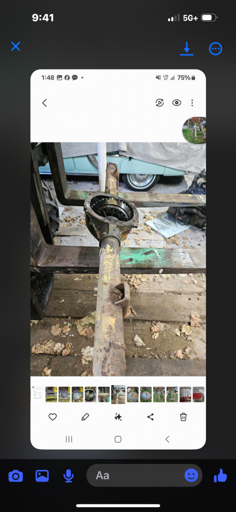

This^^^ and the one above it^^^If it is an 8.5 10 bolt,which it should not be,by application. Rob the ring,pinion and posi diff out if it.A GM,8.5 diff is a GM 8.5 diff, diff and gear set are the same car or truck. Most obvious identifier is the lugs cast into the housing at 5 and 7. Look and see if the Camaro rearend has bumps that match your rearend at 5 and 7 at the pumpkin cover.

For some reason that idea never crossed my mind, it does look just like my rear end. These are photos of the Camaro rear end here
