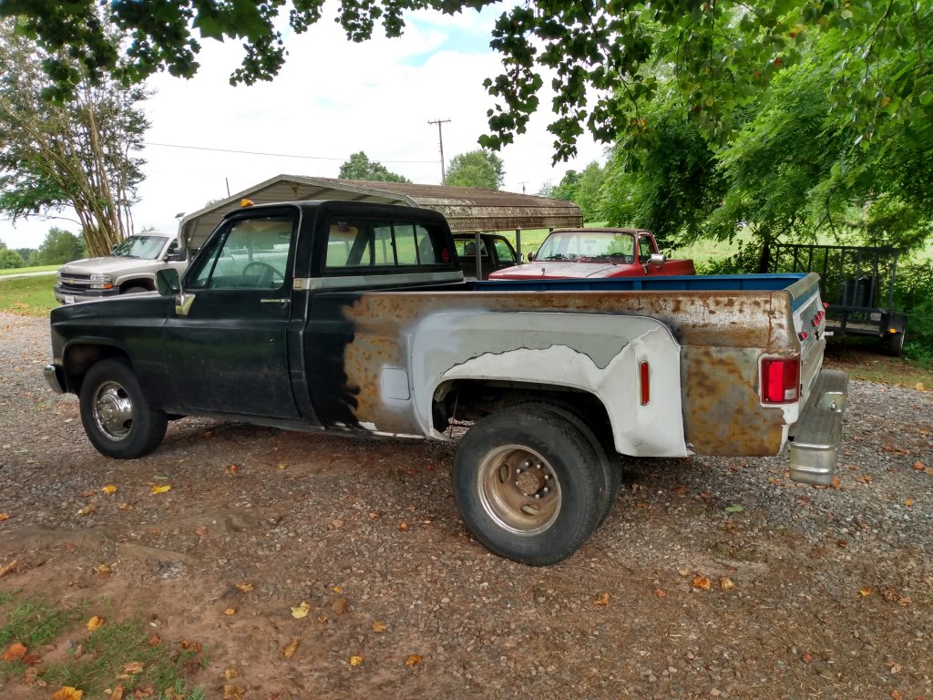

I'm going to prime my dually bed where someone before me sanding it down to the metal. I want to just prime it back for now, not painting it anytime soon.
Which primer should I use? I know there are at least three types, Epoxy, Urethane and Acrylic.

It will be subject to the weather. Catawba, NC. I'm leaning towards a Urethane Primer and might just use that Rustoleum Turbo paint on it until I get ready to paint the entire truck.
