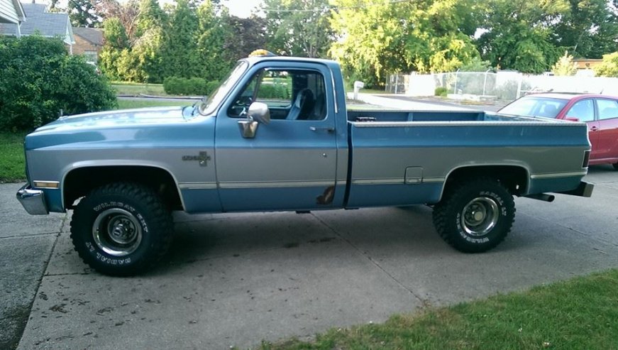

I have my 1984 square with a 355/th350/np208. I am currently running 33 inch tires and would like to stick with 33's and my current lift. I don't know how high my lift is I'll post a picture and see if you guys can tell me or if you can refer me to any reference guides that will tell me what to look for to determine my lift.

Just looking at that one pic, I'd say your running about a 4" lift if those are 33s. Your pushing it with the fuel mileage. You might squeeze another one or 2 out of it, but anything beyond that is going to be tough with a lifted 4wd and 33s. Im running a lift and 33s and a 350 and getting 4mpg at the moment, but that's carb related. What kind of carb are you running? Is there a specs sticker still in your glovebox? If so, it will have your factory gear ratio. That will make a big difference on your hwy mpg.
