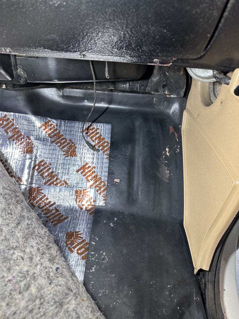

Where is this interior leak coming from?
C10SLEY
Nov 24, 2021
35
8
Chesnee, SC
Caleb
383 stroker
When it rains, passenger side gets wet down in the corner angle where your right foot would be. Looks like it’s coming from around the heater core on the right side. Any ideas where it’s coming in from on the outside without me tearing everything apart first?

Test it. Pour water over the Windshield, if it stays dry pour water in the cowl. This way you can find where the leak sits.
7,721
13,741
Auburn, Washington
Assuming it’s water and not coolant, my money is on from the seam in the cowl and possibly blocked drain hole in the bottom corner of the cowl.
As said above. When it’s dry, start selectively pouring water to help pin point the leak. Take the valance off the cowl so you can see in there. There’s a transverse seam that I believe tends to be a common leak spot. Or rust through hidden somewhere in the cowl or bottom of windshield frame (under the gasket).
Your truck looks real clean though, so not sure if it has any of the damage I mentioned above. But you didn’t mention how it’s been stored over the years.

The cowl drains get clogged eventually and water stacks up and comes in the kick panel area. Under the truck behind the front fenders is where they drain. You may have to remove a plastic trim piece and pull some foam out of the way. I've had to clean, flush, clean, flush, etc until I got all the debris out.

Thanks for the recs! The truck sat outside, but not under trees, but near them, for 7 years. Since I’ve had it, it’s been in the dry until now. It’s a pretty clean truck with minimal rust (rockers), but I’m believing y’all that it’s a clogged drain and coming in the kick panel area. The vent in the kick panel was caulked around the perimeter before I pulled it out and restored all my trim pieces. I’ve wonder if it was coming from that vent ever since, but the insulation around the heater core under the dash is very wet…. I’ll be checking this tomorrow hopefully. Been sick, so haven’t addressed it yet.

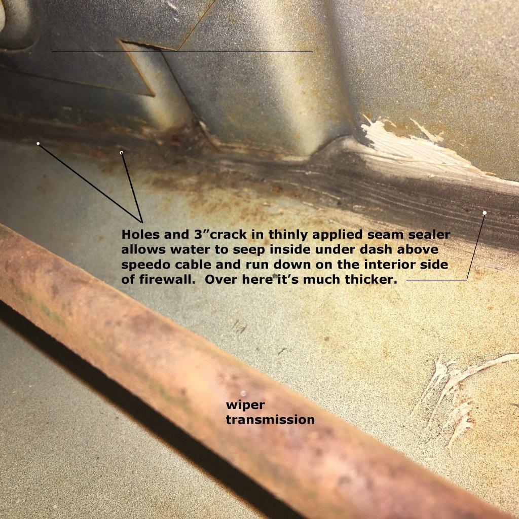

On my 82, seam sealer under the cowling was not applied very well at the factory, so it eventually cracked and leaked. In may case, water ran down the drivers side and rusted out part of the fuse panel on its way down to rusting out part of the side panel below the fresh air vent. It's worth a look.

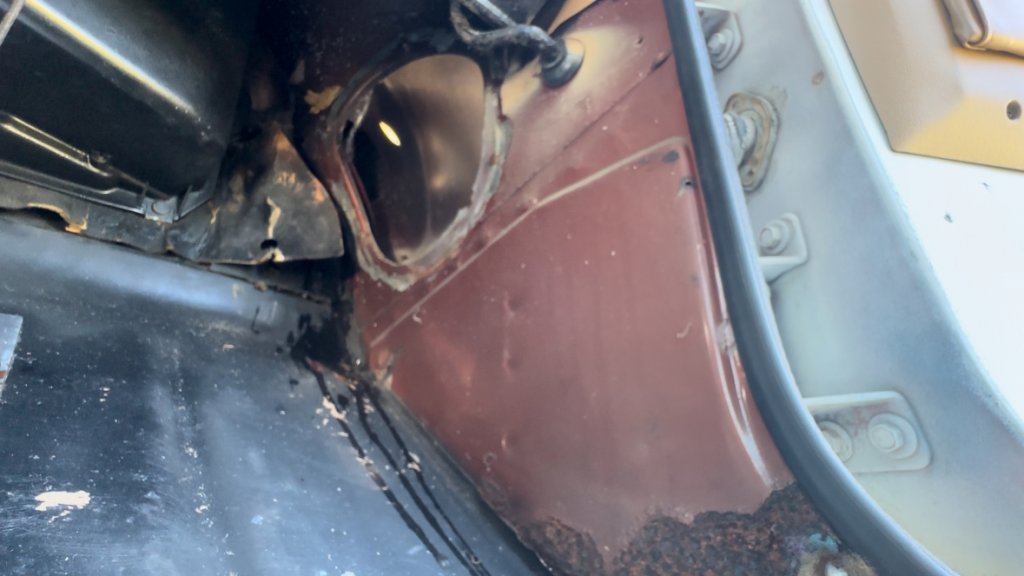

This is kinda what happened... the vent is sealed around the kick panel from the factory, and when I removed the passenger side kick panel when I was restoring all the plastics, I noticed silicone caulk around it, but never replaced it. The truck always sat in the dry then, so I never noticed a leak when I was done restoring the pieces. Well, since it sits outside now, I did.
I found the leak to be from the vent from the water that runs down the cowl and down the side and drips and hits the vent window on the kick panel and drains in. I added a ton of Lexel to both the kick panel and the sheet metal on the cab and put them back together. Putting them back together is a PITA, so I hope I got a good seal. Gave er a quick wash after with no leaks, so now that it's all dry, I need to dump a ton of water down the cowl and see what happens.
