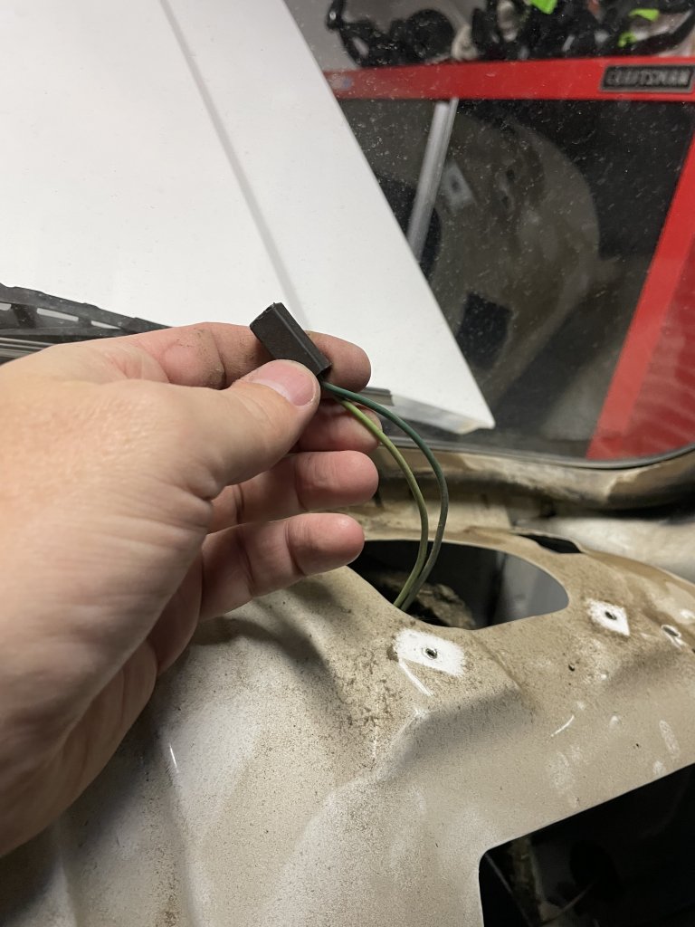

Where does this go???

It's a 85 k10 custom deluxe.

Cig lighter or dash speaker?

What about heater/ac panel lamp?
Illumination wires are typically grey IIRC
@75gmck25 is correct, constant hot should be orange
Green wires are typically associated with cruise control and A/C IIRC, I know several GM cars use green for the A/C compressor switch wire
31,892
32,686
That's a front speaker connector.

Makes sense. Truck doesn't currently have center speaker. Thanks
31,892
32,686
The truck will either have a speaker in both ends of the dash, or the center speaker. But not both. I don't recall which location used those colors, but I do remember that the lighter shade of green is the ground.

Left and right end speaker plugs have an angled connector though.
I can't tell in your photo if that hardshell connector is straight or bent at an angle.
