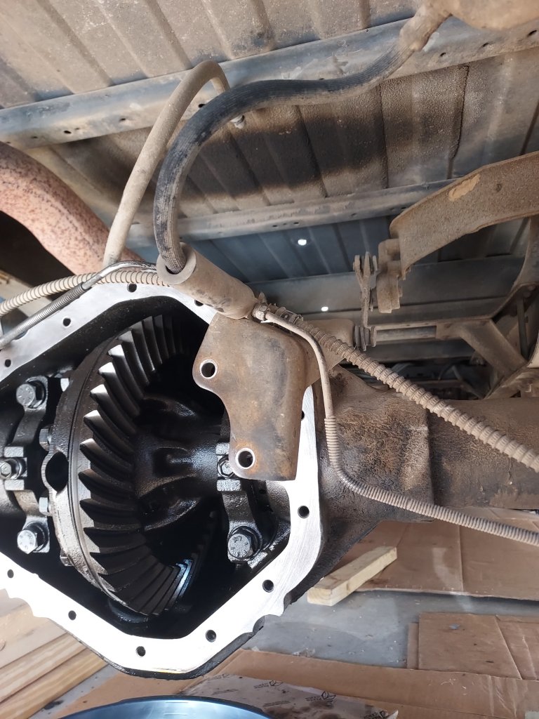

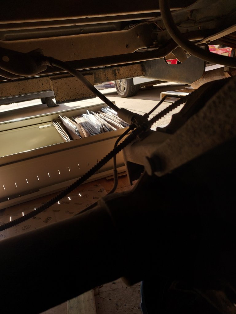

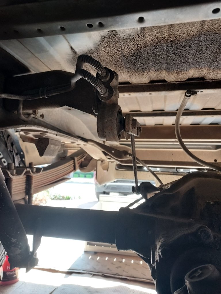

So, the rear brake line feed this dohicky that is attached to the rear diff. It then goes around to a t-fitting and feeds both rear drum cylinders.
Reason I'm asking is I'm pushing denatured alcohol through to clean lines before attaching to new cylinders. We good men?
Truthfully, mechanically it doesn't look like it does a damn thing and is just there to f with my head! :oops: :laughing1:

Its a load proportioning valve. It limits the amount of braking action on the rear brakes when unloaded so that they don't lock up, while still allowing max braking when loaded heavy in the bed. If you are trying to flush the system, I would disconnect the lever from the diff and put the arm as high up as possible to allow max flow to the rear brake cylinders.
Ah, ok. Lever is disconnected from diff since we're changing oil. So lifting it up obviously opens the valve...
