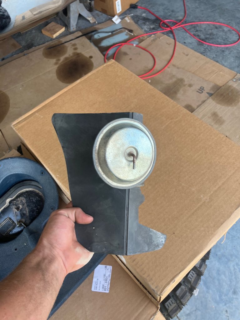

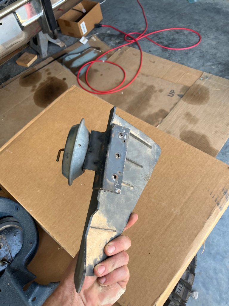

My pickup is a 1979 Silverado; but the cab came off of a 1977, I think a Scotsdale.
The guy who was working on my pickup left me several boxes of parts, and I have to figure out what everything is and where it goes on the truck. He threw away lots of parts that are needed.
I found another part that I think looks like it is part of the heat and AC system; it is a vacuum actuator attached to a flap. But I have no idea what it is or where it goes. Below are a couple photos of it.

More pics, then plug them into google image search.
Or, are there any part numbers on it?
I needed to figure out where a heat shield went today, and I found a part number stamped on it. That lead to a parts diagram and thus the solution.

Isn't that the vacuum actuated fresh air inlet in the passenger footwell on AC equipped cabs?

Recirc door actuator. Goes on the heater box inside the cabin

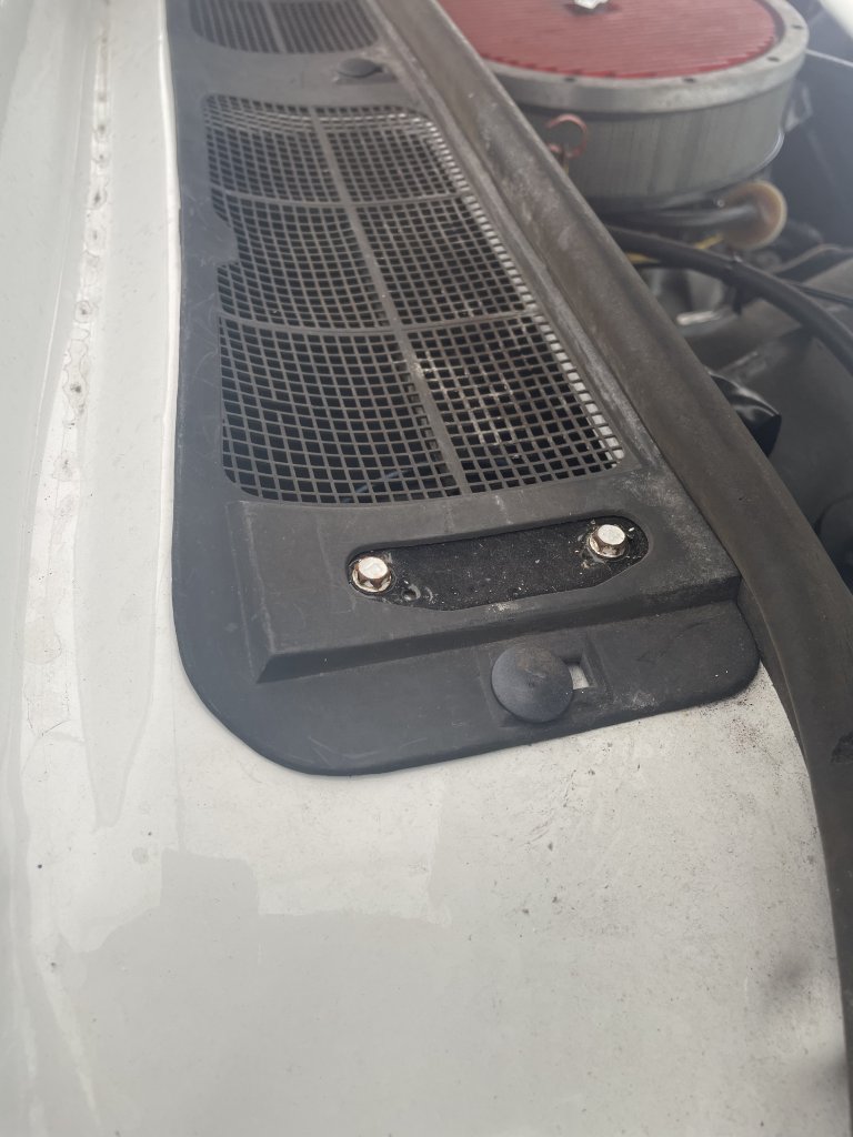

These are the 2 bolts that hold it

I did find a number on that part, 6262685-A.
That photo showing where it bolts onto the cowl helped me a whole a lot. And I found a vacuum hose laying in that place to plug it into.
To answer the question from Sad Sack; I can tell by moving them with my hand, that those two vacuum actuators work very different. Also they are a little different size.
