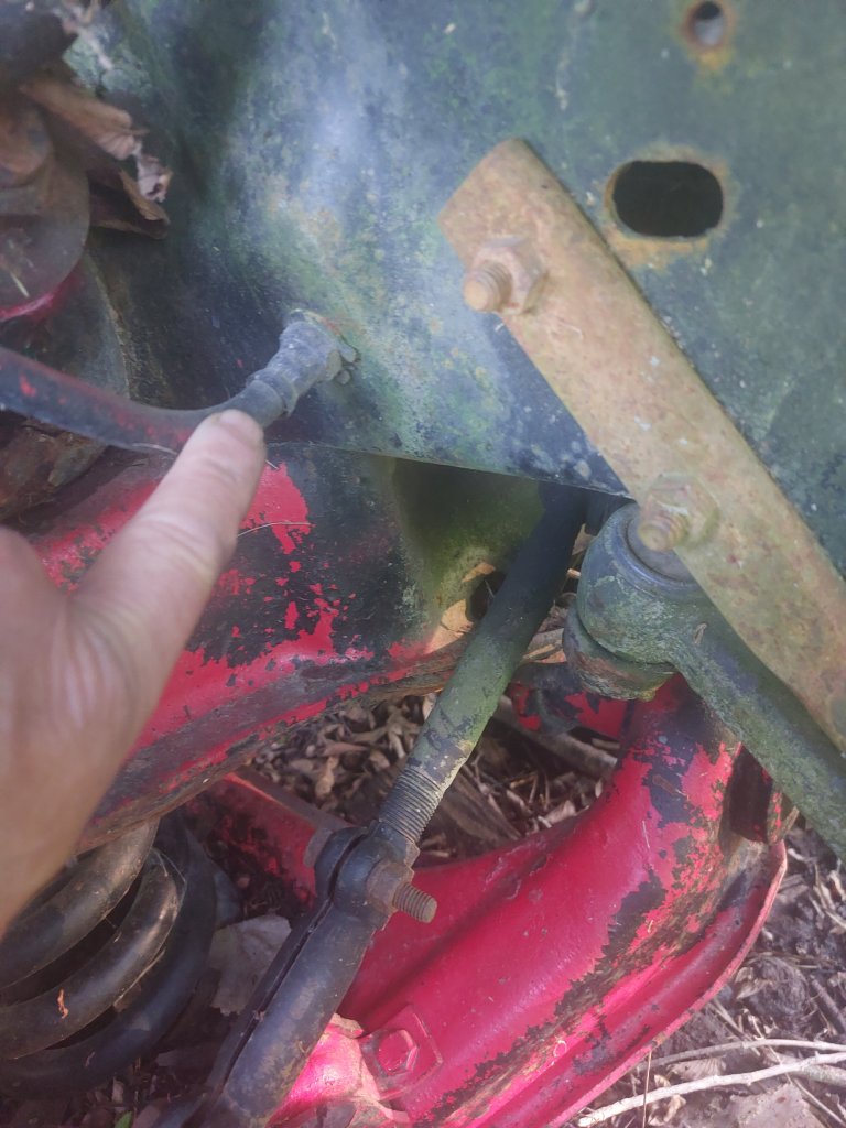

If I buy the fittings I need then the hose. I could just cut it to size? Right?
4,128
5,991
Just add to your existing steel lines and relocate the end to use your stock hoses, 3 couplers 3 steel lines,a little common sense,fab some brackets or zip tie them.done!
4,128
5,991
Don't quite understand? I just need to extend the rubber part.
Extend the steel lines that the rubber lines screw to,then use existing rubber lines. I took a pic for you the steel line is behind the rubber line unscrew the rubber line add an appropriate length of steel line, bolt a bracket to the frame to hold the longer steel lines and hook your hoses back up.
