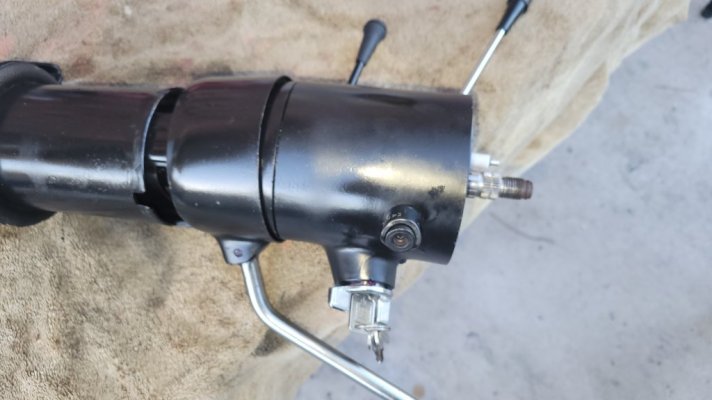

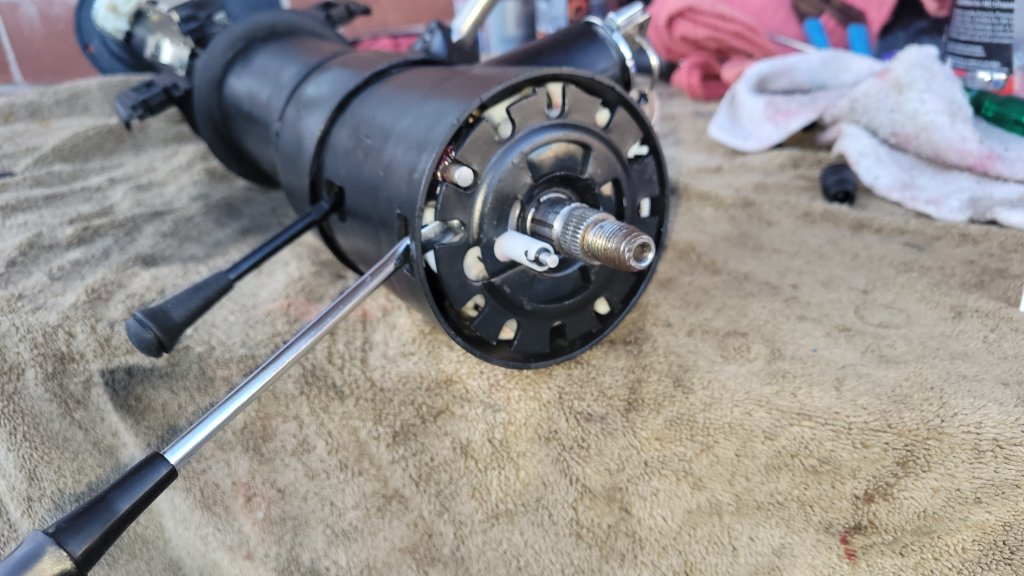

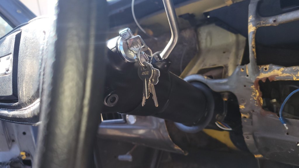

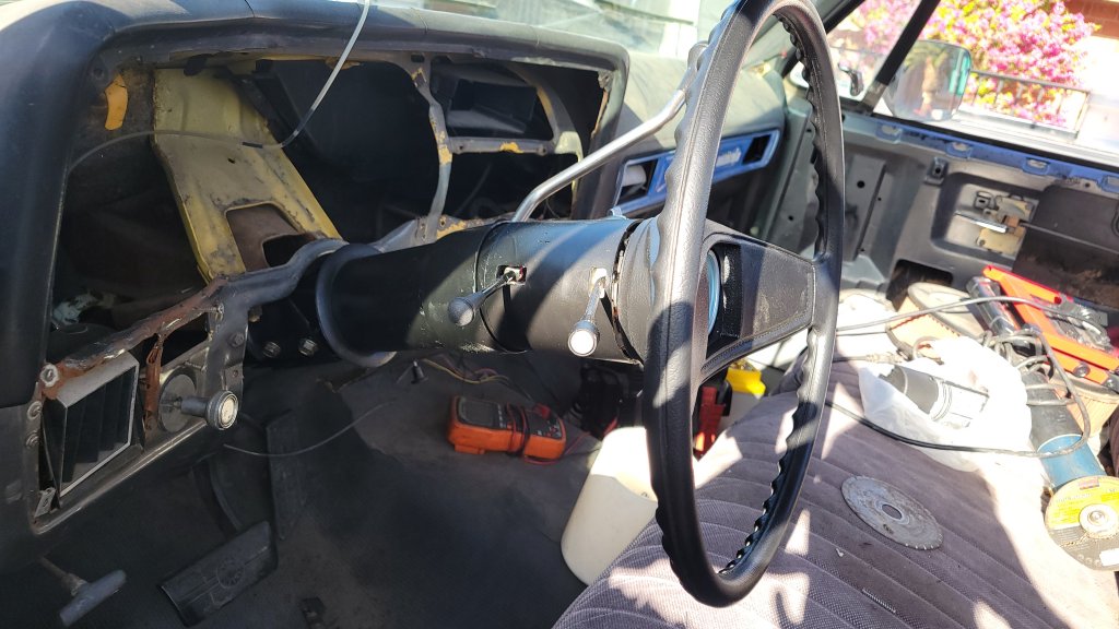

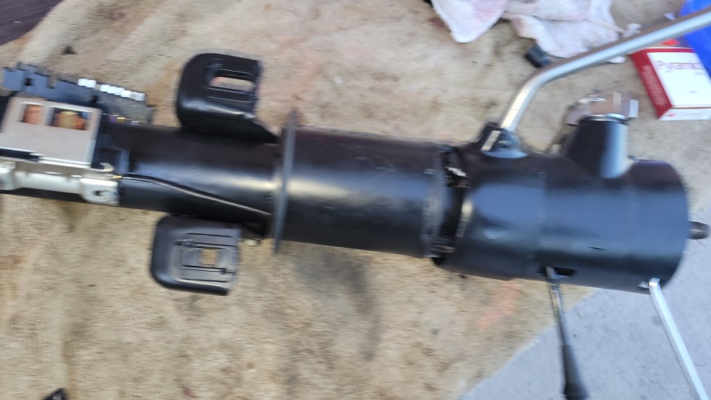

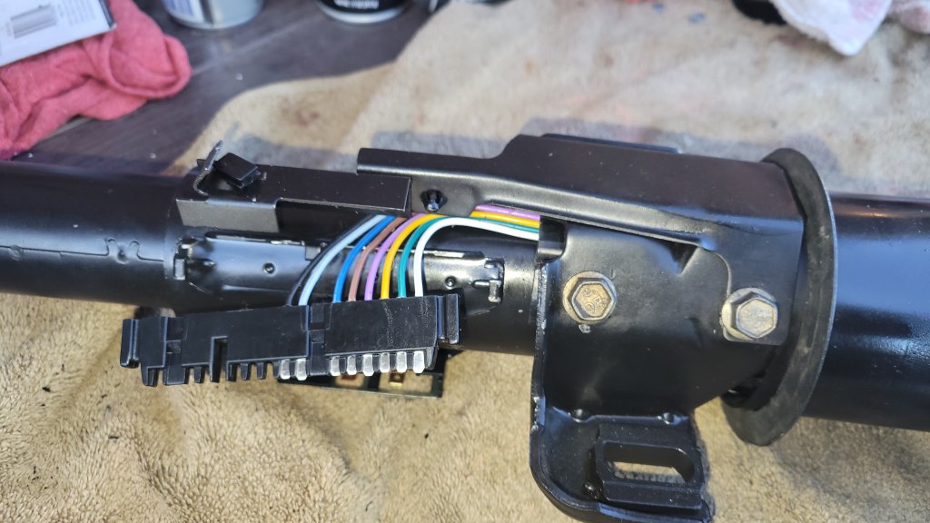

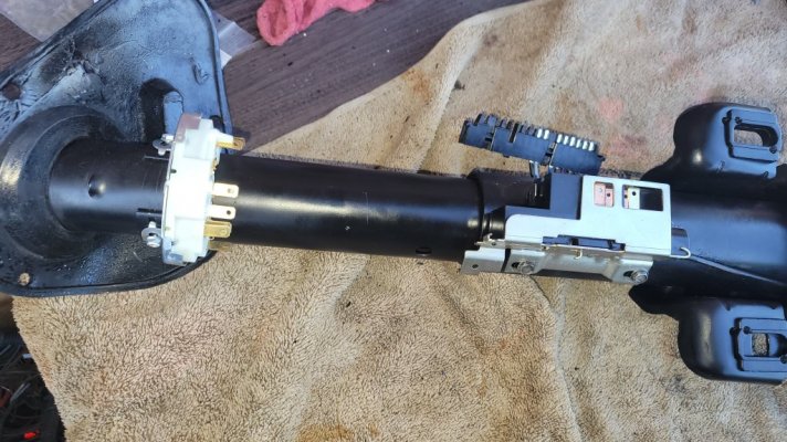

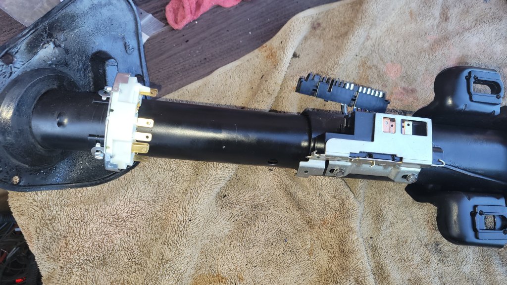

Another quick update. Finally have the column put back together. Everything I could find a replacement part for has been replaced with exception of ignition cylinder, because that was pretty much already new. Brand new "factory" steering wheel and button from LMC will be installed after I get the column mounted again.
I've never had to take something apart and put it back together so many times. I'm glad I'm done with it

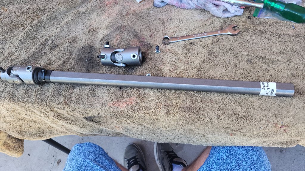

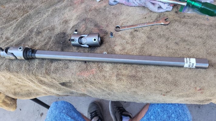

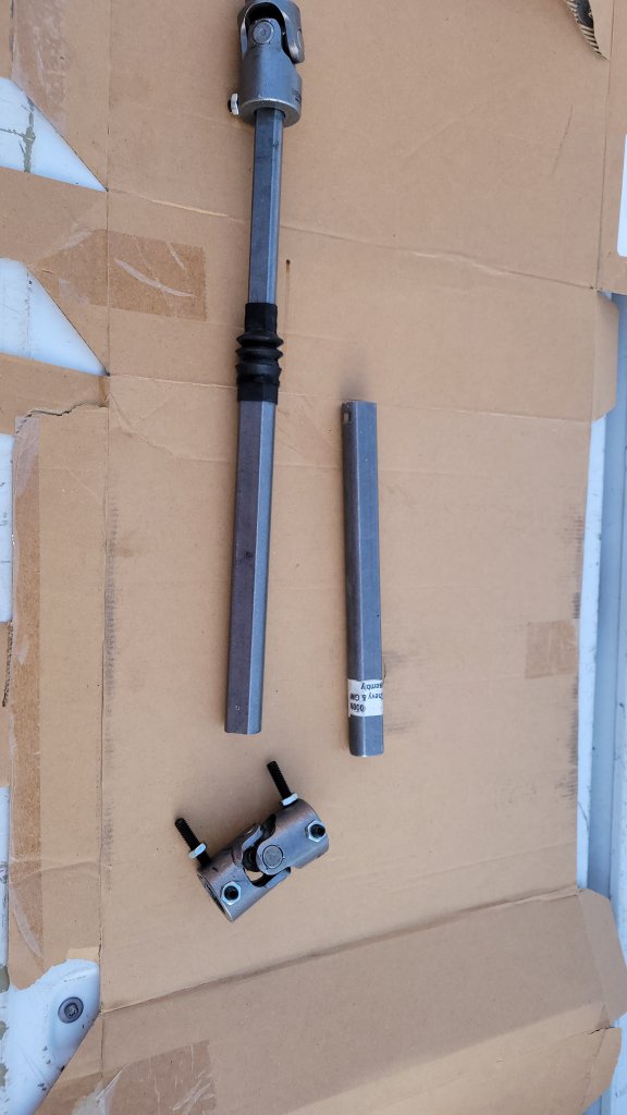

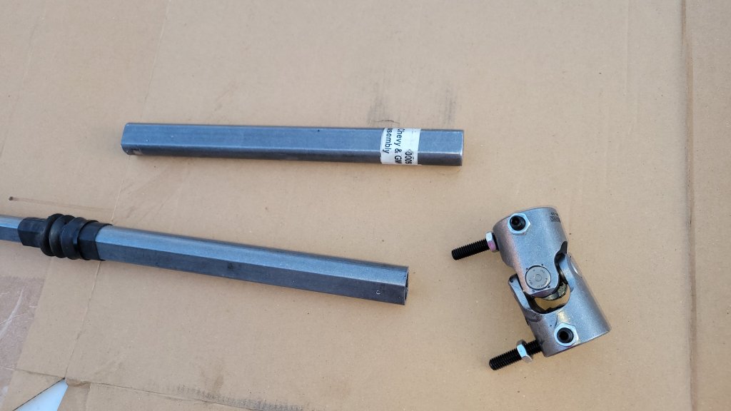

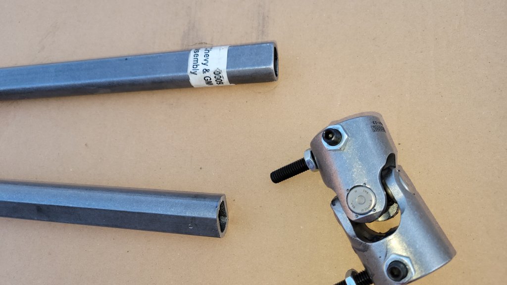

New Borgeson shaft, getting ready to get it cut down, fit, painted and installed

Okay I've gotta ask,as a tech I have replaced at least,seriously at least 10 sloppy ujoint steering shafts to every 1 rag joint I've ever replaced. What is the big attraction to the ujoint shaft? I've used ujoint shafts in Mud trucks,but just because it was the easiest solution to the relocated everything.
I'll let you know after I drive it with the u-joint installed. But from what I've read, the steering will be a lot tighter. Mine was pretty sloppy because of that old ass rag joint. I needed to replace it regardless, and didnt want to go back in with a rag joint

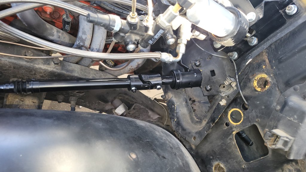

Got the shaft cut down to length and painted up today. Hopefully will have it installed, and the column all tightened back up, by end of week.

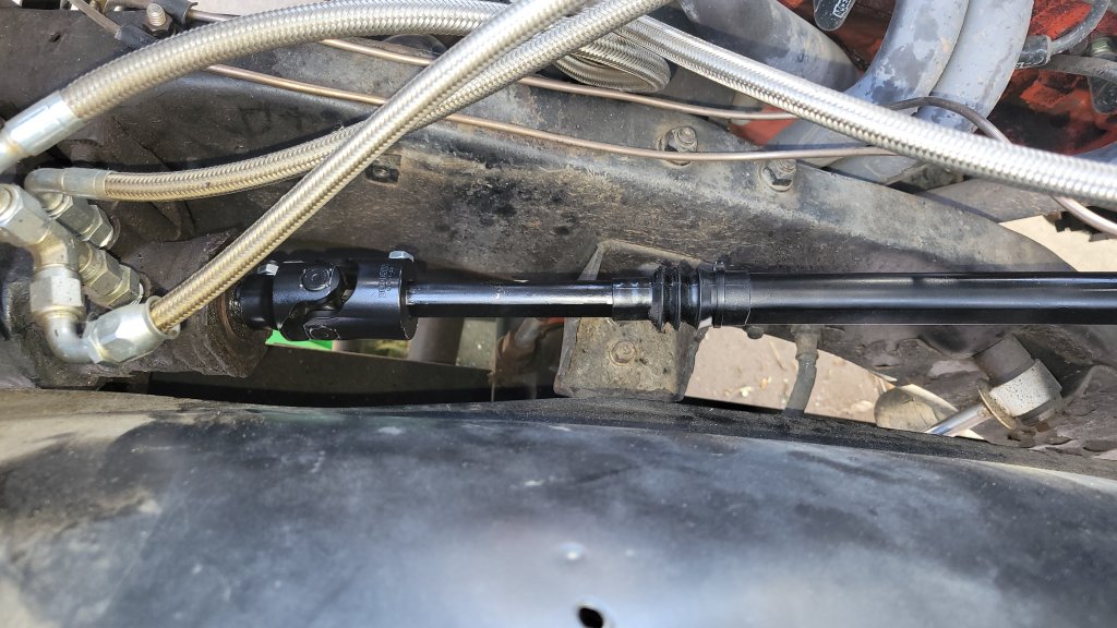

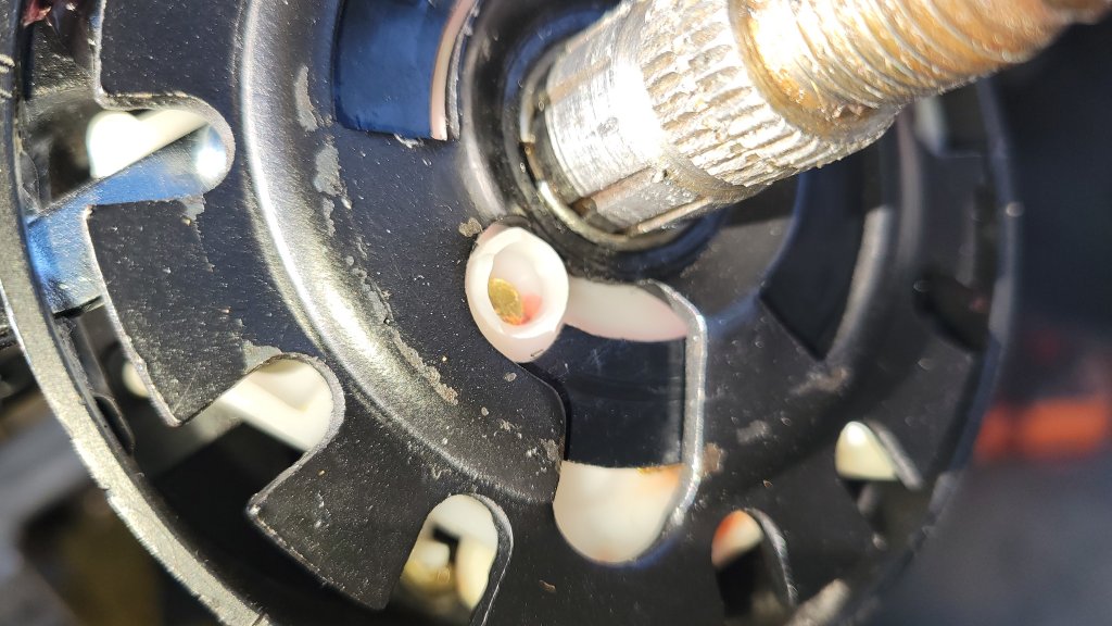

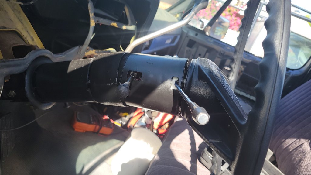

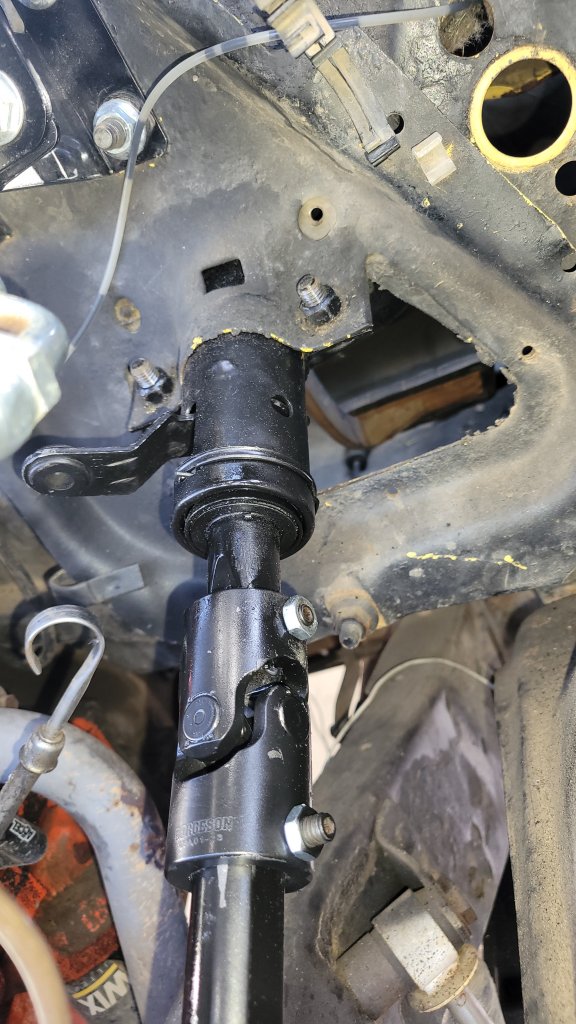

New shaft installed. I broke the horn button stubout thing on the cancelling cam when I was putting the new wheel in place, so I'll have to buy a new one of those

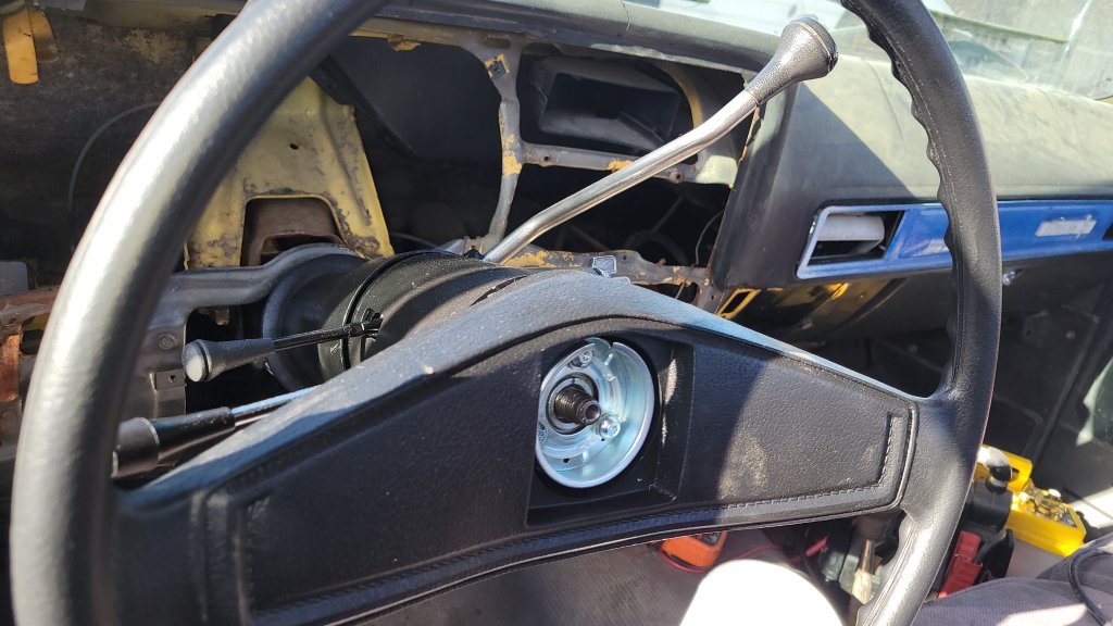

What a $300 steering wheel looks like. $60 horn button pending

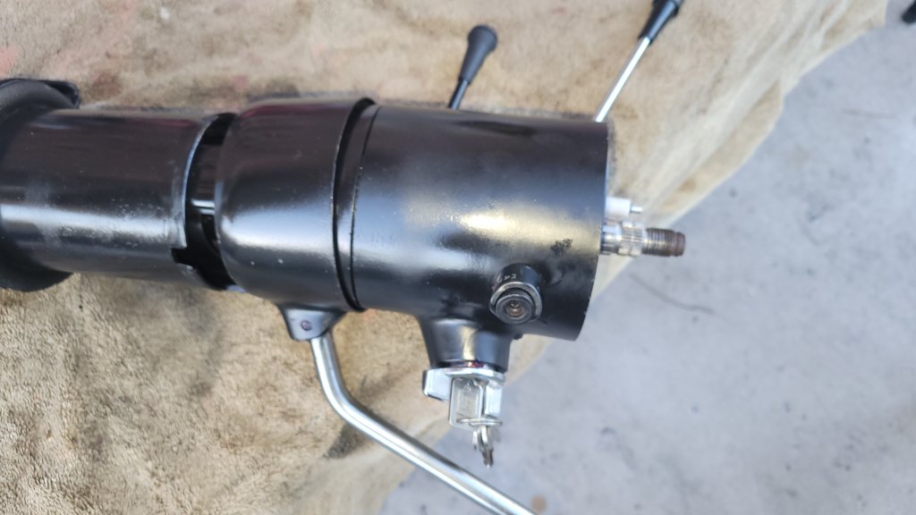

Final post for this thread. Steering column is finally finished! I'm still missing the horn contact pin that went flying when I broke off the nipple on the last turn signal cam, but the cam itself has been replaced. The pin can be installed just by removing the steering wheel. New steering shaft and lower bearing in as well. It still hasn't been driven, as I need to get the wiring harness done next. But it looks great and already feels tighter and smoother. Thanks all for the help
