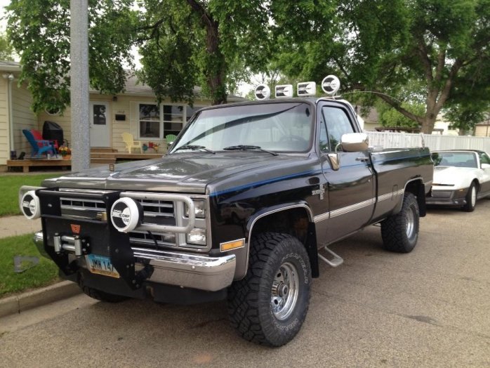

Mod done
The shop cut out the template in 1/2" steel, I primed & painted with engine paint. Most things lined up. I was 1/4" off the bottom hole of the brush guard which interfered with the light. But I got the look and functionality I wanted. Hello license plate and it sits back almost 5".

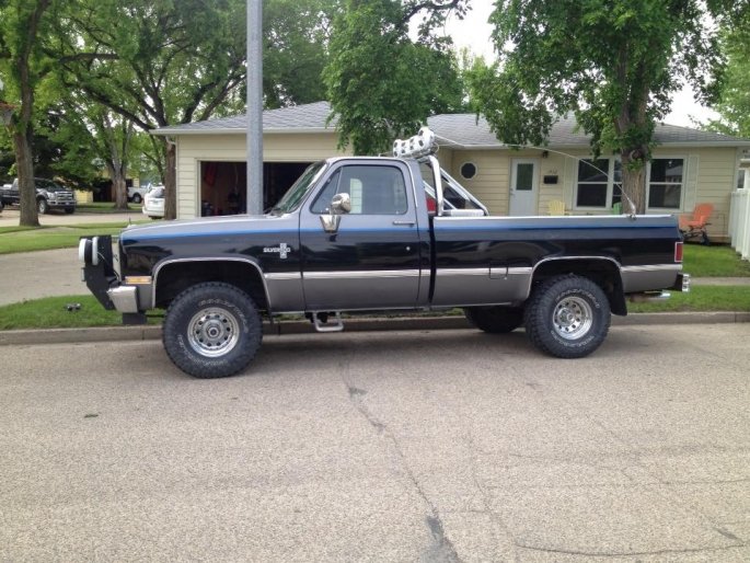

Template cut.

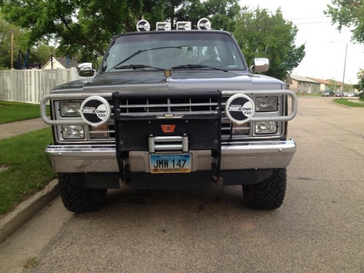

Head on
