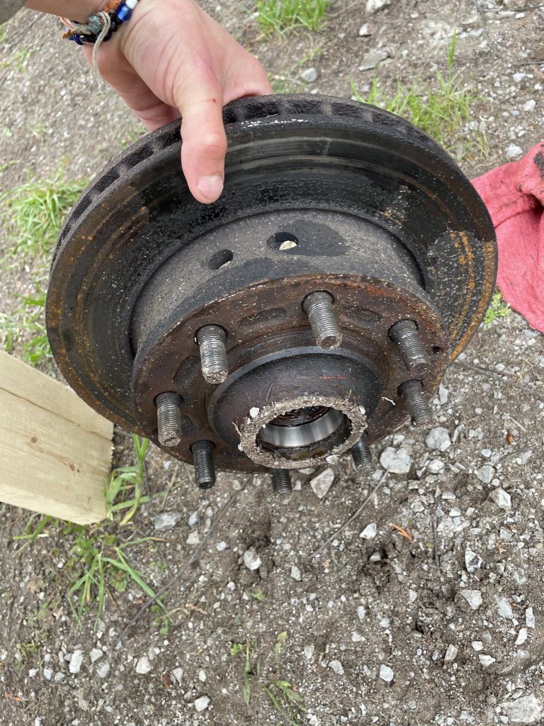

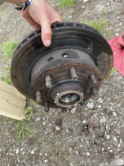

PLEASE HELP I GOT AHEAD OF MYSELF AND I DONT KNOW WHAT TO DO LOL
okays so i was feeling all dandy and was like imma do my brakes cause they suck and they need replacing and so ive got the parts and i didn’t realize that the rotor on the truck was a rotor and hub and now i have no hub. Looked around and i cant find anything and mostly cause i have no clue what im doing. I mean i watched some videos but seriously i wasnt expecting this and i was stupid and didnt look at it first. Here are the new rotors i got and heres the olds with hub
I did do some research about the new rotors though and ive heard these were good so i got them
New rotors
Link^
Old rotor/hub

Is there a way to take the old rotors off the hub?

Post this in this forum so more people will see it. I can't really help you with this because I've never replaced them. But somebody else will help you.
