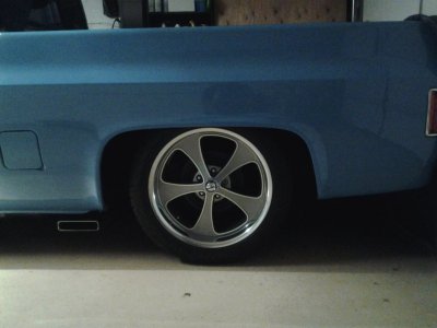

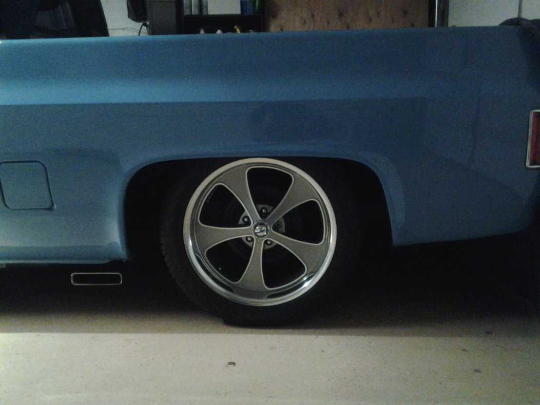

Here's mine 5 front 7 rear drop, using coils, spindles.....flip kit, hangers and the overload springs removed. Rides great and very responsive (especially since replacing all the rubber with polyurethane.
I have 20x8 up front and 20x10 out back (removed and fabricated custom front inner fenderwells)
