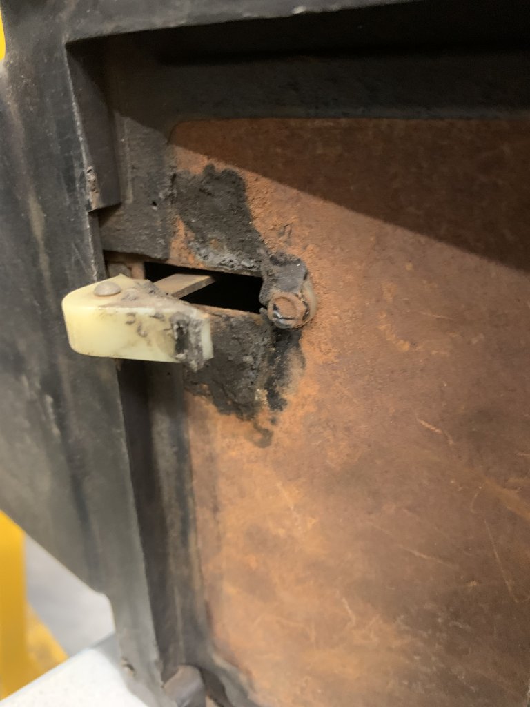

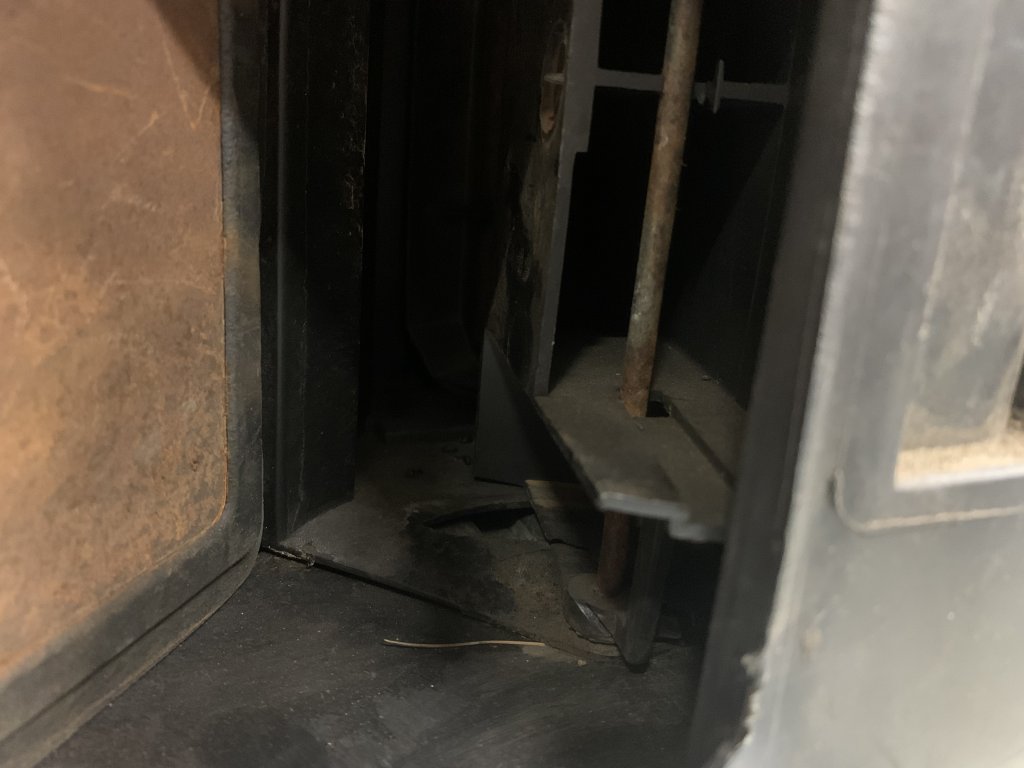

Well unfortunately i ended up pulling the hvac box but not because of nests.Turns out two of the doors are broken. Please see pics. Does anyone know where I can find these parts? Also. How to adjust. I believe they were adjusted incorrectly. The metal door was butting up against the plastic door and not shutting correctly. This seems incorrect to me ??? Honestly i really only need a good strong defrost if all else fails.
Btw i did find nests, they were in the dash vents so the right thing to do was pull all the ducting even though i got all the nests out the ducts were sticky and nasty.

Would anyone be able to explain how the above doors are supposed to function? In other words, in what relation should the metal door be to the plastic door (baffle i believe its called)
I looked abd looked for this, found videos that start to touch on it but nothing definitive. Both doors are busted up so I will have to disassemble.

Yes and no, i found the “baffle” they call it, the plastic door. Its worth its weight in gold. So that one i will try to repair.
And the metal door, the plastic latch they make a metal replacement for $16, so i have that coming. But i believe due to the baffle being broken, when i actuate the doors by hand they hit eachother so the metal one doesnt fully close and seal the box shut which i believe is wrong. And i need to know where the baffle is supposed to be. Hopefully it will be more evident when i take the box apart.

Assuming your truck is a runner, hook up the vacuum lines and move the controls around to see how it works leave some of the vents off so it doesn’t block your views.

My ('87)Suburban has had a funky smell from the vents when I first start it since I bought it last August. The heater core started leaking enough recently that I am 95% done with the process of changing it. I hope that was the source of the funk- no evidence of critters. Some of the doors are vacuum actuated and at least one is cable. Apparently the white plastic clip in your first picture is prone to breakage- there are aluminum replacements available online. The metal flap and plastic duct thing do interact with one another somewhat during the vacuum transition. I confirmed operation of the (two)vacuum canisters on mine before I reassembled it. Fortunately they all held vacuum.
