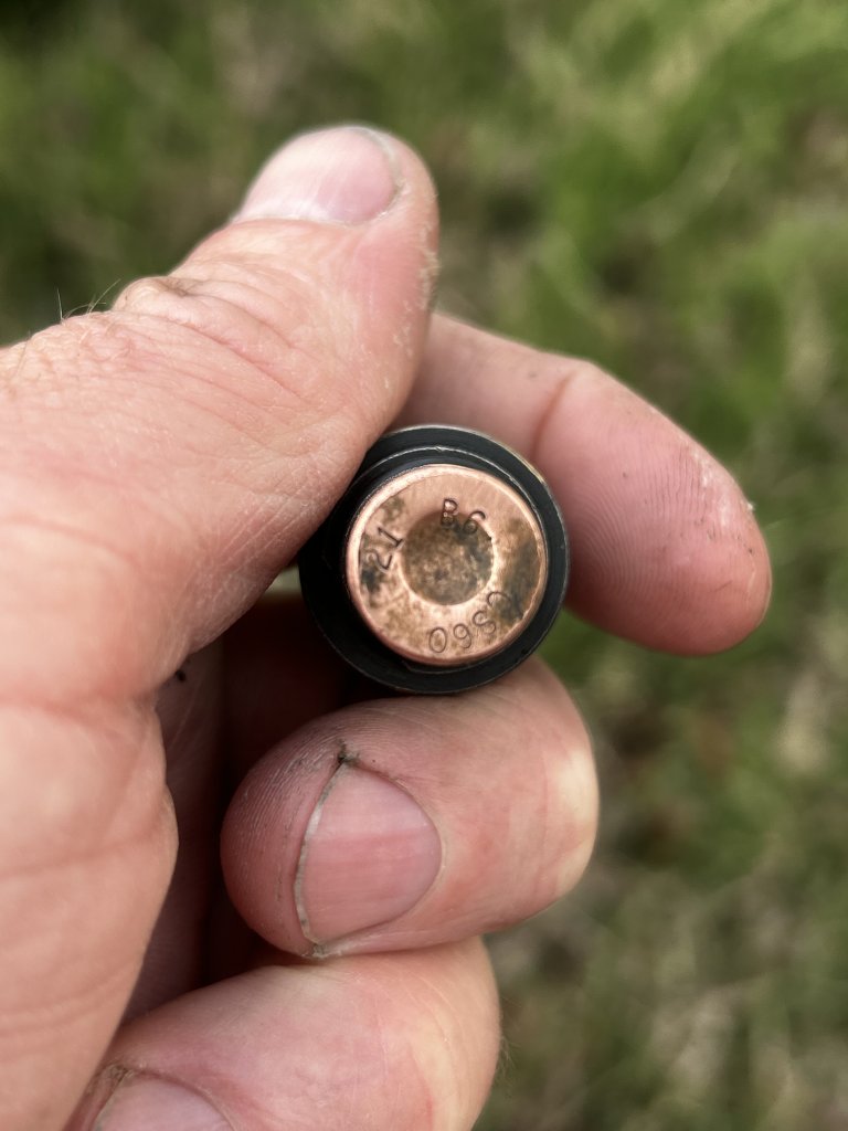

This was hanging back behind my 86 5.7 350. I have been feeling around for a sensor port, and searching the part number I have nothing. Maybe it used to work with the AIR system or a vacuum pump I don’t know. The yellow and brown wire does not help me. It is tapped to the green wire that I believe is the coolant sensor.

Looks like the cold start sender for the 6.2 diesel.

I’ll have to check the VIN if it originally had the diesel. Old fire suburban with 5.7 350

Truck has always had a 350 5.7 in it so don’t know why it would have a 6.2 sensor in it. It does look like one! I’ll remove the distributor and poke around for an open port some one may have added. Beyond that if no one knows I’ll start some amateur electrical TS. Truck needs a rebuild but I want her to move a little more first.
