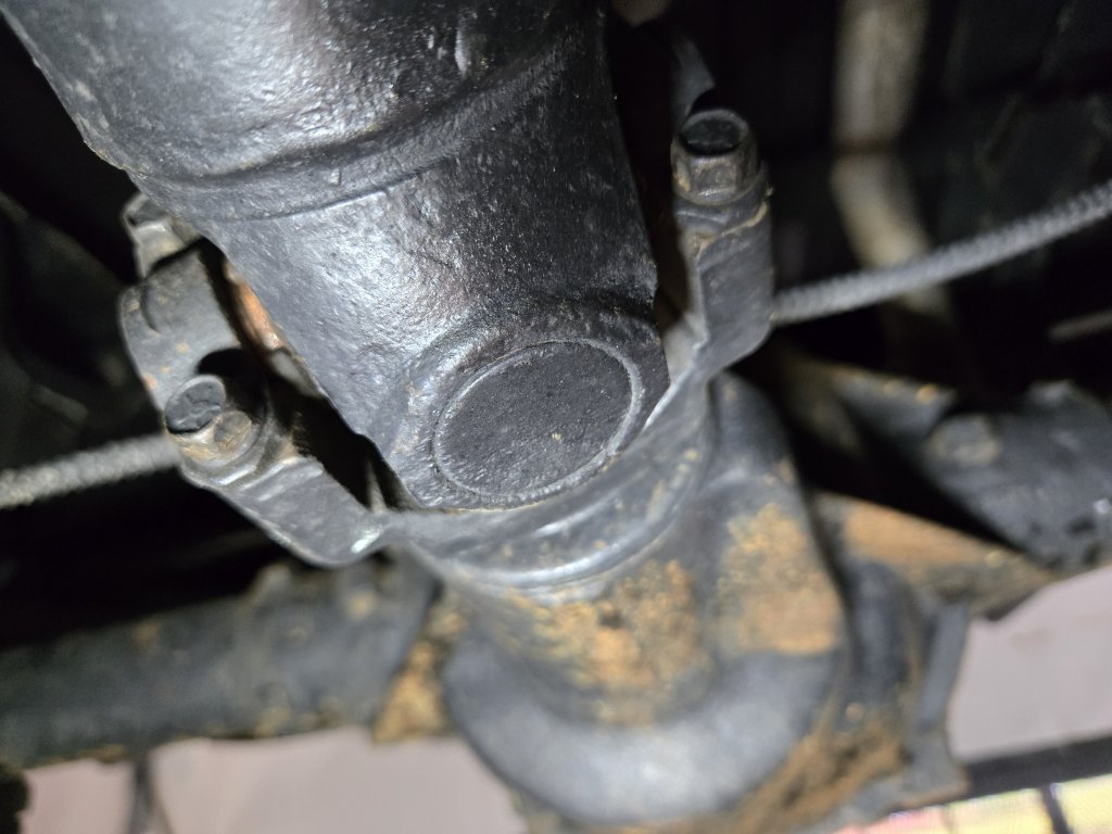

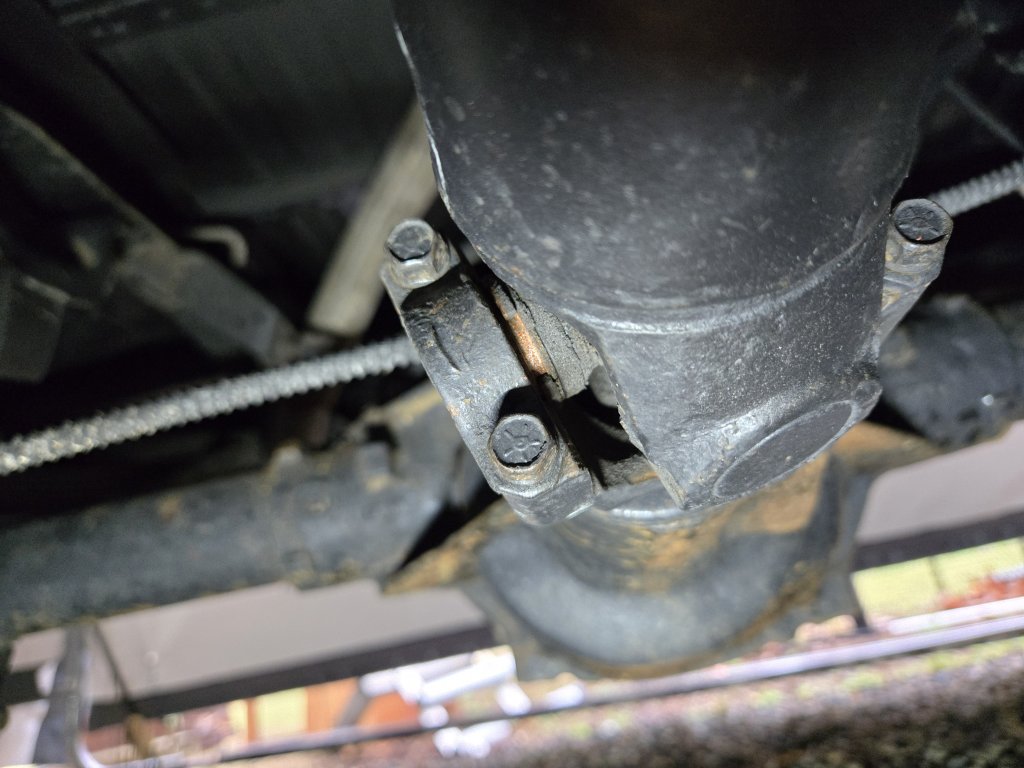

I want to replace rear drive shaft ujoint got new ujoint with exterior clips is this right ? It looks like factory ujoint
No you need the u-joints with the inner snap ring. Same as comes out has to go in. Buy Spicer u-joints.
