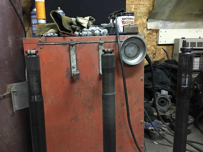

All depends on tire size and how your launching it. If your gonna upgrade your carrier it only makes sense to go 30 spline and swap out the axles. Either with 12 bolt axles from an earlier model which will be the same length with in a few thou or 89-91 Burb or Blazer axles. But if they come from an 89 make sure you count the splines because 89 was a half year. Pic in order left to right. 28 spline 87 8.5,30 spline 91 Burb 8.5,30 spline 77 12 bolt the Burb axle looks to be a bit beefier.
