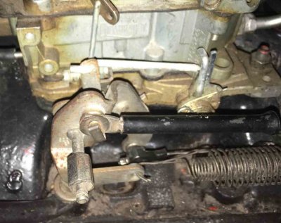

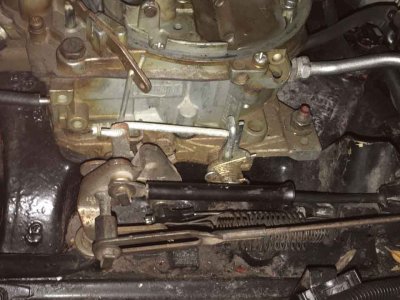

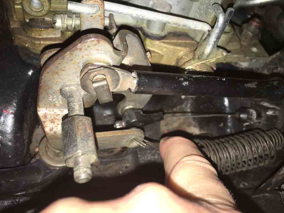

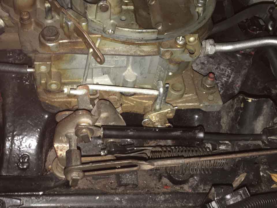

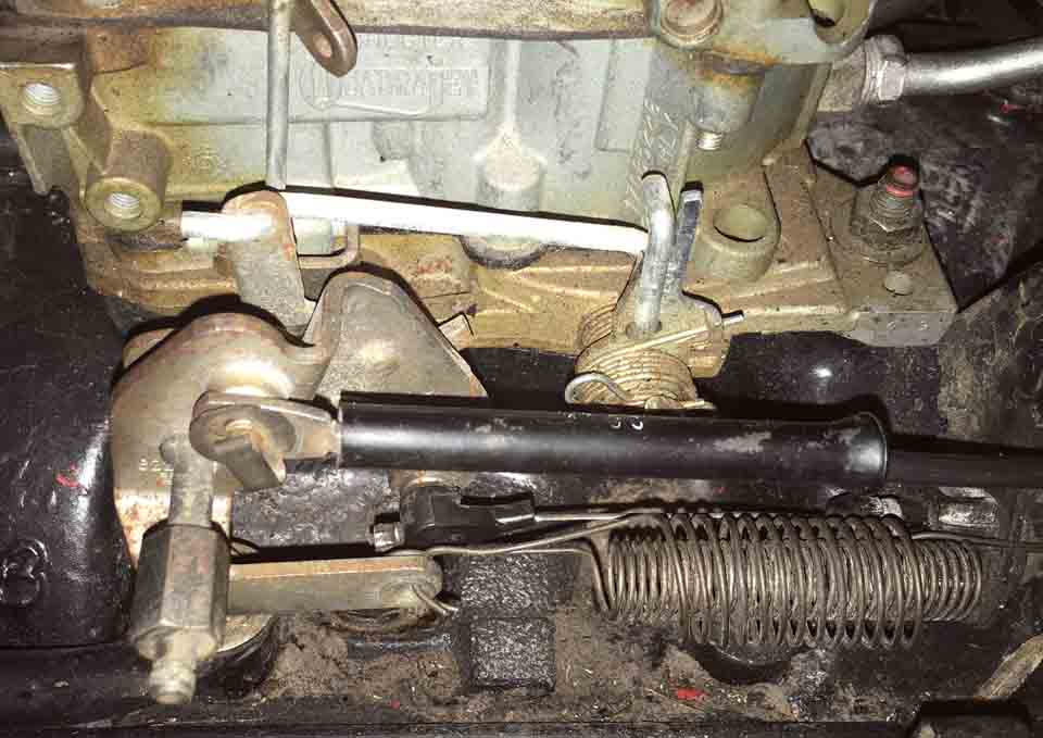

Got a pic??.
InVision
Mar 7, 2017
39
Northwest Florida
here a a few. took cruise control off to see linage better.
Thanks,
M

Is the cable original? When I first brought my '88 home, the hacks who had worked on it previously didn't inspire much confidence so I readjusted it. couldn't get it to really adjust properly , so I made a trip to the dealer, and picked up a new cable for it. That one adjusted as it was supposed to, and I haven't had an issue with it since.

Wow I guess I am lost. The cable is loose at idle and can't go any tighter at WOT. How would a different cable change that? I was thinking it was the linkage on carb that could be wrong. The TV cable being further away from pivot point would change indexing.

Don't look like the cable is in the right spot on the carb????..
Never mind, guess it is in the right spot.

The cable looks tired to me, like @CSFJ said. I wouldn't suspect valve body problems unless you had more major problems with it shifting, which could then be a number of potential problems. I would just get another cable and try it out. Even if something happens to the transmission soon after, the cable is almost certainly reusable. Make sure you get the TV cable grommet to seal between the plastic cable sheath where the bolt goes through and the transmission housing. I forgot and had to that job twice after the murderous amount of trans fluid that leaked. What a bitch. I learned the hard way that you gotta lop the whole assembly over the transmission so both ends of it are down there with you and pull tension on the cable part so the two fishhooks don't fall apart while you bolt the sheath down back down. After you get that done, you're home free.

So I read the service manual I found on this site. Great Job BTW!!
The TV cable operates very smoothly and does not bind or stick. So I adjusted the cable so that idle position is where the TV cable starts and pulls back to on its own and at WOT is the max position it extends. At WOT it is tight like a string instrument.
Will test this evening if I can.
Learning a bunch working on this ol' truck !!
