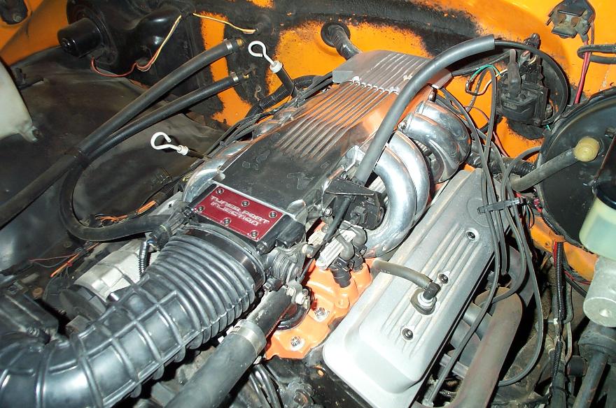

24 years ago was my first EFI TPI swap...work great nice little set up...and today is cheap ;)

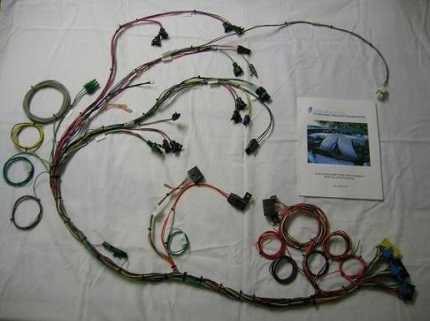

There are lots of benefits to a modern control and holley has a harness to run a tpi injection with a terminator so it really doesn't matter if you don't get the factory harness or pcm with them anymore. Plus the Holey will be much easier to tune an tolerable for nicer sounding cams.
