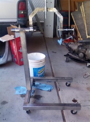

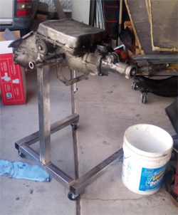

Hey guys, I'm back. So, I have a 4L60 ready to be rebuilt. I have all the parts (Mostly Borg Waner) a Sonax sun shell, new bearings, sprags, bushings and a stand to do all the work on. Here's the before photos and I'll have more as the build continues.
Wish me luck!!!
