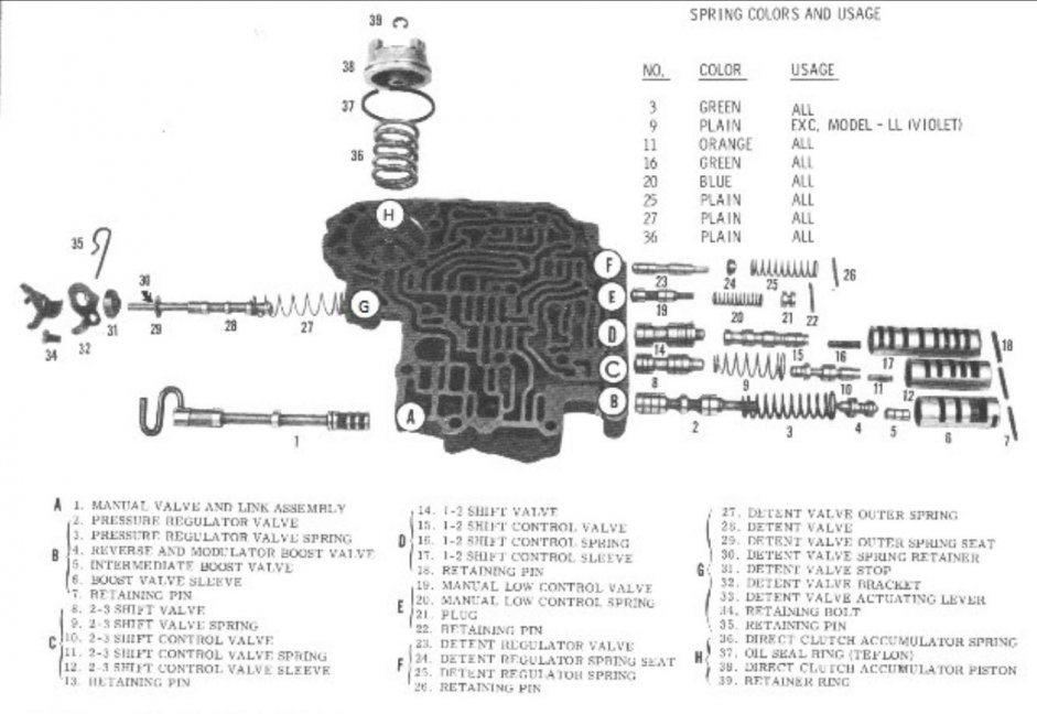

I toasted the forward clutches by having 1 spring in wrong in the valve body, could have been something as simple as that. Tomorrow when I'm at my pc I'll post an exploded view of the valve body, might be the easiest place to start checking.

Here's the view of the valve body, note some of the springs have a small end and large end, that's what killed my forward clutches, just putting 1 spring in backwards. Might have to download it to view it full size. Hope this helps...
