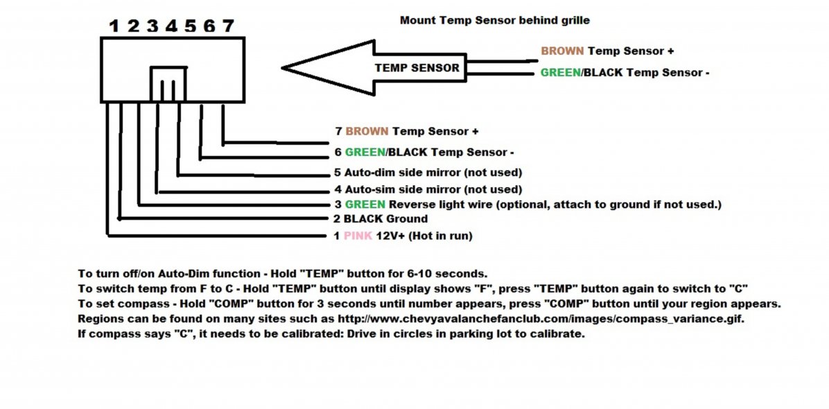

Which one do you have?
This is for a Gentex and Donnelly with the 7 pin connector.

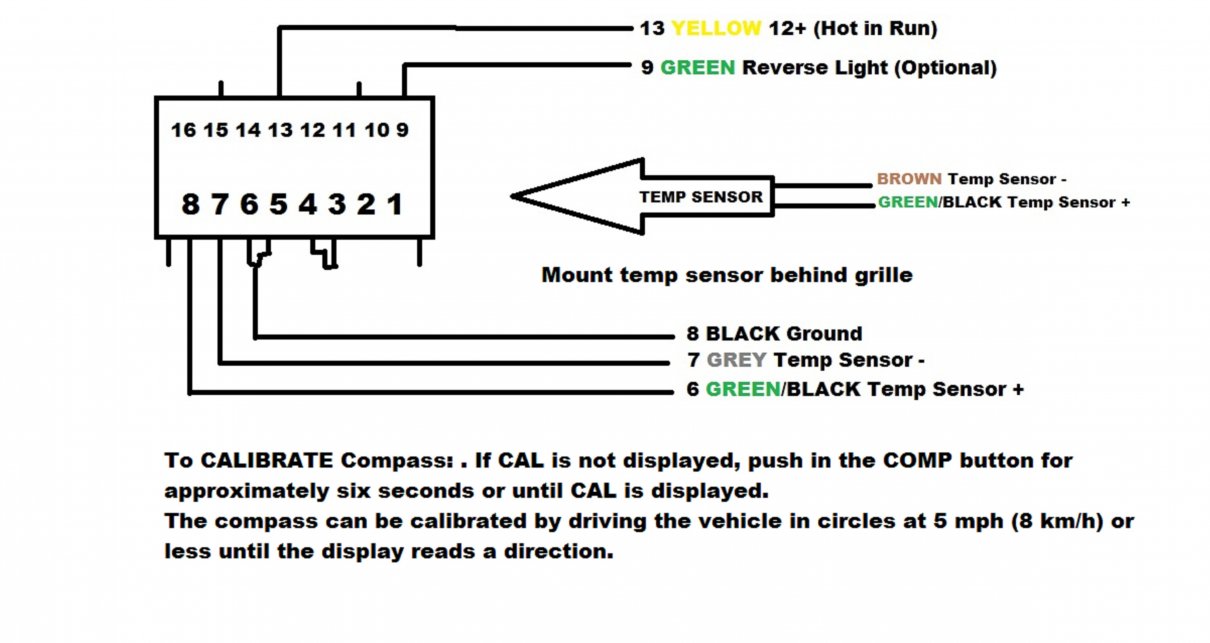

And this is for a Gentex and Donnelly with the 16 pin connector.

Thanks Retro that's what I needed. You would not believe all the mirrors at the pull a part yard I went to today.
BTW I got the 7 pin. Still need to go back and grab another for the wifes blazer but I want to get 1 for hers that has map lights also, and didn't have time to look around any longer.

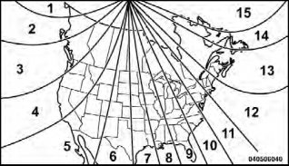

is this the variation map? I presume we are in #6?

We are actually in Zone 7.

thanks much better map then I had mod please remove mine

I got one today from work it has 5 wires. they are black, green/black, purple, solid green, and yellow but it has th 16 pin connector. Will this be an easy one to hook up?
:Edit: ok so in better lighting the purple wire is actually grey.

The purple is probably a faded gray but they may have used purple. Use the 16 pin illustration in my post above.
