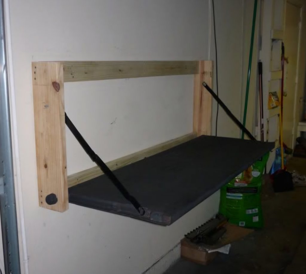

anyone know where to find stepside tailgate wall mount brackets?
I found a set a couple of years ago (brother trucks maybe?) but now can not find them. It is brackets to mount the tailgate to the wall to make a workbench or seat.

Easy enough to make. I'd use 2x6s screwed to plywood. 2x6s as uprights a plywood back screwed to keep them from spreading and so you can hit enough wall studs through the plywood for support. Or use angle iron on plywood.
