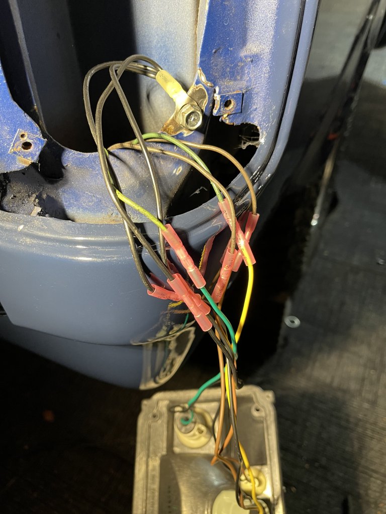

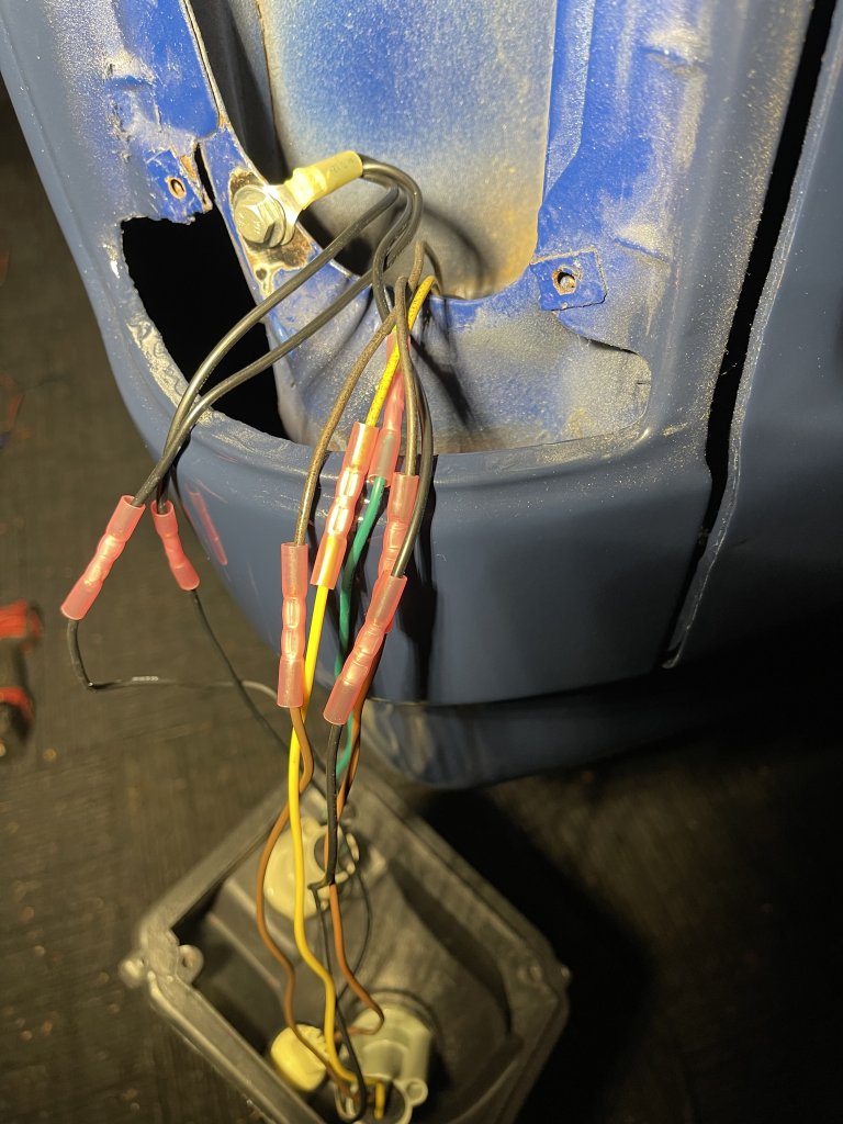

Ok … so, before I started fixing up my wiring mess all my tail lights worked. Since then I started going through the wiring in the truck and there was 3 splices in the tail light harness, I decided to cut out almost all the wire goikg from the firewall harness to the plug in the back. I color coded the wires and created a new harness. All the sockets were corroded in the taillight housings so I replaced them as well. I made all new ground points and grounded all the grounds to the body that were coming off the new sockets. All the wires were basically the same color on the new and old wires so I connected everything the way it was. When the headlights are on I have nothing in the back, when I use the blinker only one lit up. It didn’t blink tho, so I started pulling the wires apart in the back of the truck.
I want to replace a lot of this stuff. It’s old and brittle. There seems to be this heavier gauge brownish coke wire running to all the sockets and possibly the old license plate light.
Can anyone help me out here.
My buddy is coming over this weekend to help me out with a few things. This being one. I was hoping to have some insight into what we are looking at.
Thanks

Those crimp connectors aren't going to work very well in the long run if you'll be driving where they'll get wet... they can be made just passable by cramming the splices with dielectric grease.
First, I would double check to make sure you've got the right wires to the right places, and connected to the right filaments on the bulbs.
Brown is for tail, side marker, and license plate lights- dim filament on bulb.
Yellow is left turn/brake light- bright filament.
Dark green is right turn/brake light- bright filament
Light green is reverse.
Black is ground.

I wanted to cut all that out and rewire the back wires. I don’t like the old crimp connectors and the green wire is breaking.
Good info. Thanks

X2 on the butt splices (crimp connectors) ,use solder and heat shrink.

Here is the wiring diagram for the Rear lights. This may help you understand why the all the wires look the same at the end.

The ground can take all of the lights out, or if any of those 3 splices are grounded stuff will not work. Make sure all of your bulbs are good! The housings for the lamps are good. It's only 4 wires fix it.
