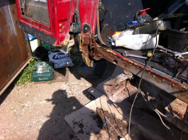

I building 88 Suburban. Today I started repair of tail. Anybody knows how to repair tail-pan?

And driver side

Here is my install with pics. You have to cut out a section of body panel on one side to get the part in and out.

Thank you for pics! I can't to bay this parts. There very big for shipping.
Today I removed tailpan and started cat and weld. Everything is not so bed!

Anybody knows how to replacement the rear floor? Do I need drilling spot welding?

Cutting and welding, if you want 100% stock then spotwelding is required, but you can get away with plug welding In my opinion.

Yeah over lap the good metal and plug weld it fuggit. And use caulk to seal the seams.

I weld MIG/MAG. I think that this is enough.
