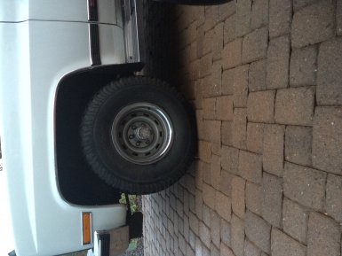

It has the factory wheels, I checked the code in the glove box it says they are rally wheels but it doesn't list the width. I'll upload a picture of them.

Those are 15 x 8 (rpo code n67) so the width is ok for a 12.50" tire. Typical aftermarket rims (Eagle 058) that size have 3.250" backspace so you can take one of yours off and measure for comparison. The part of your first post about the guy saying "there wasn't enough backspacing" is a little confusing since more backspace means less clearance between the wheel and the suspension components. Maybe he was talking about having enough negative offset?

I know he said backspacing and that was part of my confusion. I understood backspacing to be what you have just described and thus assumed he was just trying to sell me wheels. Thanks for the information! I knew it was n67 but couldn't find a source that listed the dimensions for that wheel.

All of the information I have found online says these stock 15x8 Rally Wheels have 4" of backspacing. Does that sound right?

Sounds about right in my book. I believe these trucks came with about 4-4.5" of backspacing.

Got the lift and tires done. Had to remove the factory running boards but it clears just fine and works great on the rally wheels.
