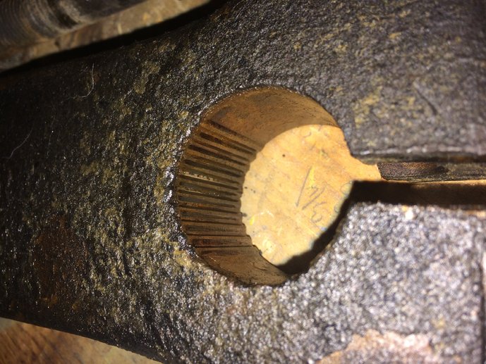

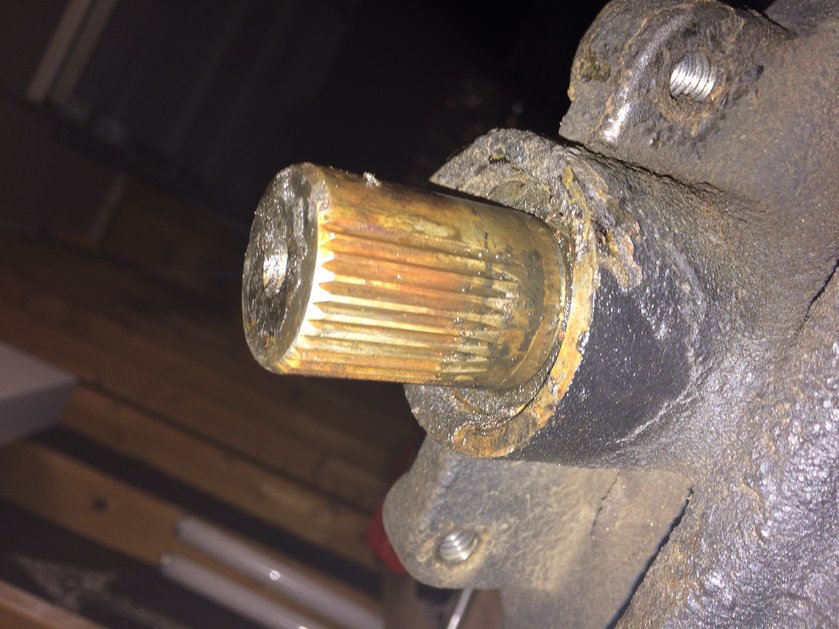

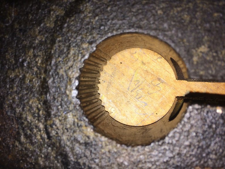

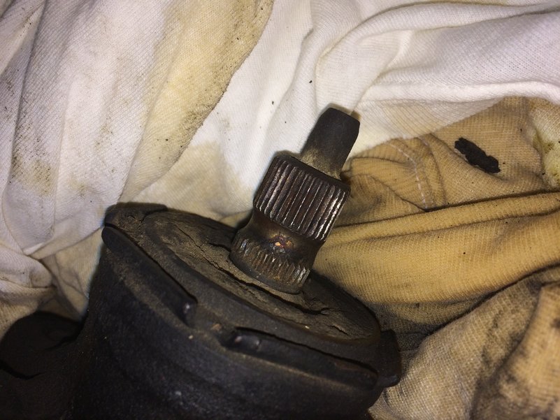

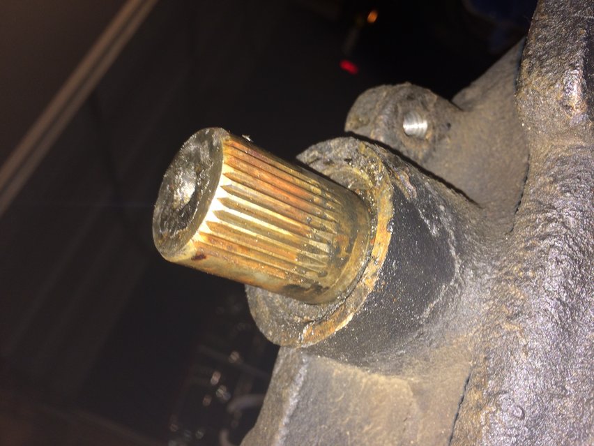

Hey guys, so first post here, looking for help. I have a 76 K20 scottsdale with a 9" lift and 44" super swampers. Truck has stock steering box, stock draglink, but has a drop steering arm. Basically, when i picked up the truck, i swapped out the 44's for some 33's so that i could load it on the trailer i had. Test drove just fine when i tested it with the 44's on, but then got it home(with the 33's on), and went to pull it into the driveway and it didn't want to go in the direction i was steering it. When it's sitting in the driveway, i can turn the steering wheel, and the tires will turn, but there's a popping noise coming from underneath by the steering. But when i jack up the front end, the wheels turn just fine with no popping noise. I couldnt pin-point where the popping was coming from, so pulled off and opened up the steering box, and it all looked good in there, no missing teeth or nothing. Pulled off the pitman arm, and it looked fine as well. Draglink looked fine as well-not worn out. I attached a few pictures of the teeth on the pitman arm and of the steering box, and also a video of the popping noise. I just cannot figure out what is wrong. Only thing i can think of is that the teeth on the pitman arm look a little worn on the tips, so maybe the output shaft of the steering box was skipping over them when im driving it because theres pressure from the truck going straight and then me trying to turn the wheels? Any input you guys have is greatly appreciated!!

Well, it's currently sitting on the work bench. I took it out and the input shaft turned just fine by hand, all the way to the left and all the way to the right. I spose it could be different when its hooked up to the steering column, cause i didn't try that, but it sure sounded like the popping noise was one of being under a lot of pressure/strain?

From the sound of it, I would think its the pitman arm skipping teeth, they look pretty worn down too. With 9" of lift, I would look into getting a dropped pitman to go along with the raised steering arm. Your steering box is putting out the force, but the angle of the drag link isn't helping it with the leverage.

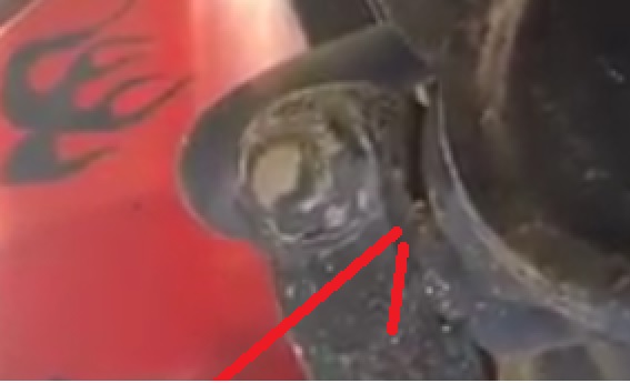

On the video, If you look closely at the shaft where the pitman arm clamps onto it, you can see it slipping, or maybe I'm seeing things.

I zoomed way in and didn't see that. I think it would be a good idea to use a stethoscope or screwdriver to the ear and touch it on various components and find where the noise is loudest.

I saw it also Val before I read your post. Watch the white spec (top one) during the video. May not be where the sound is coming from, but I think it's slipping a few degrees.

That's exactly what I was watching, the specs.
