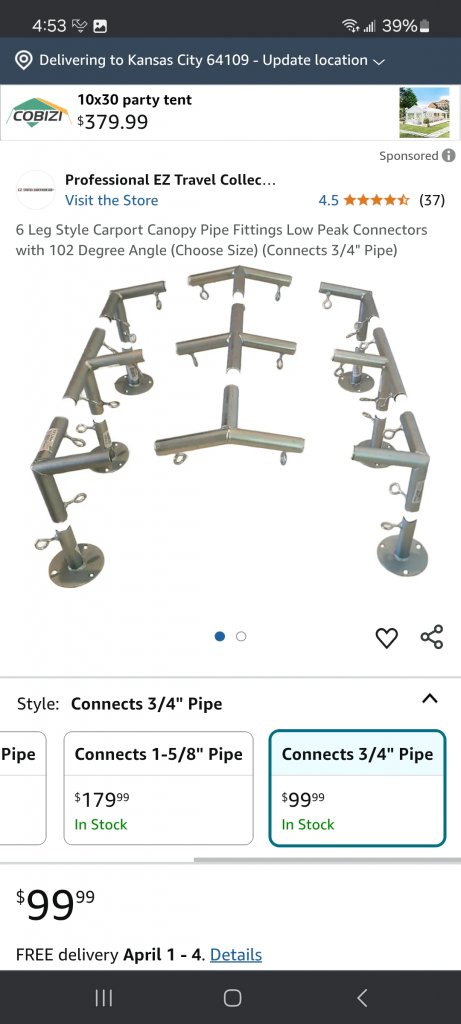

Build your own. Emt( conduit ) and tarps. Much more versatile and stores easy. I'll try to find a link for the fittings. Ventilation,blow through using fans and furnace filters. Do not draw through. I made my fittings using short sections of next larger size conduit,easy if you can cut and weld. If you make your own grind the galvanize away from the joints,weld outside and hold your breath. Welding galvanized creates cyanide gas.

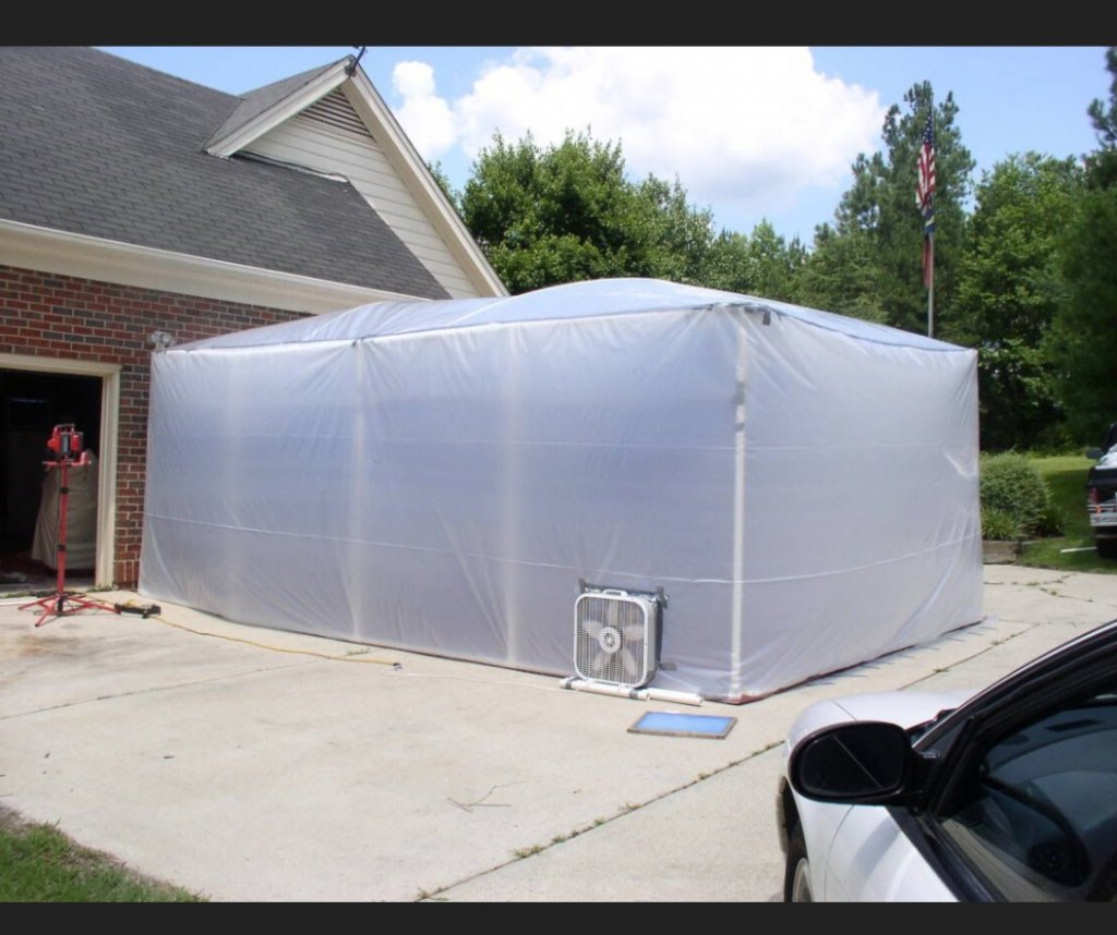

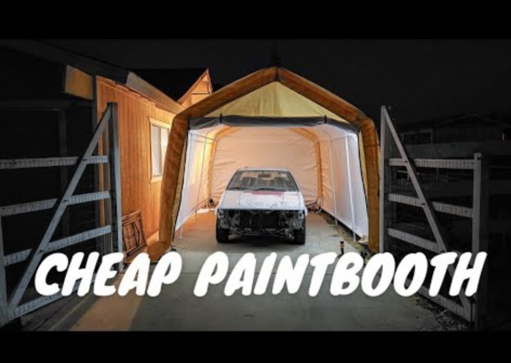

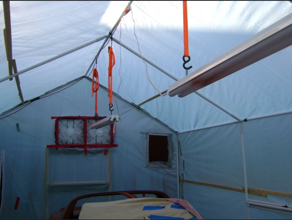

I painted a truck in one of those carport canopy tents a few years ago. Wasn't the perfect conditions but it worked. I did it open air but have seen others improve there's by cutting holes and attaching a couple box fans and filters onto it. Found some random examples pics online.

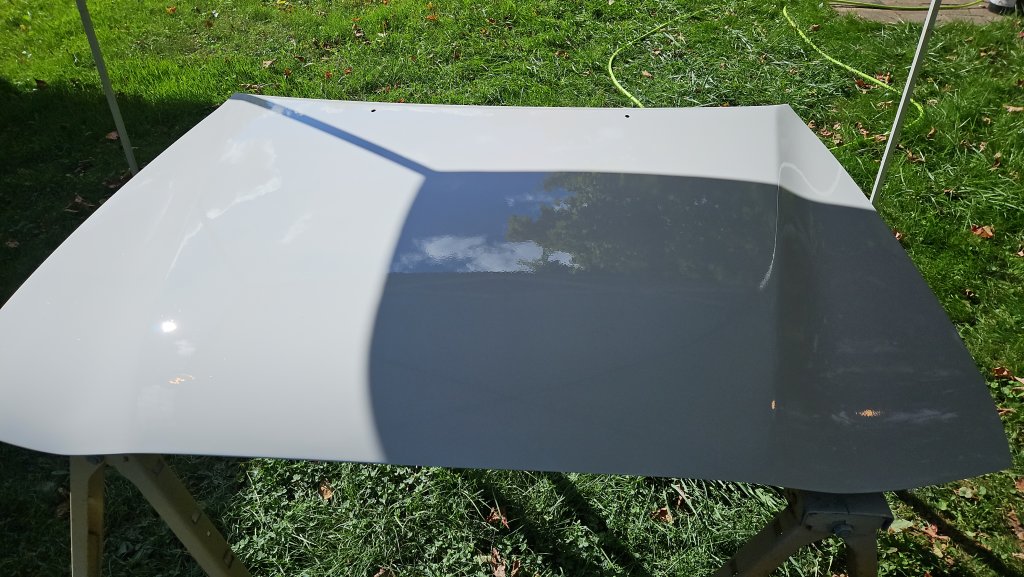

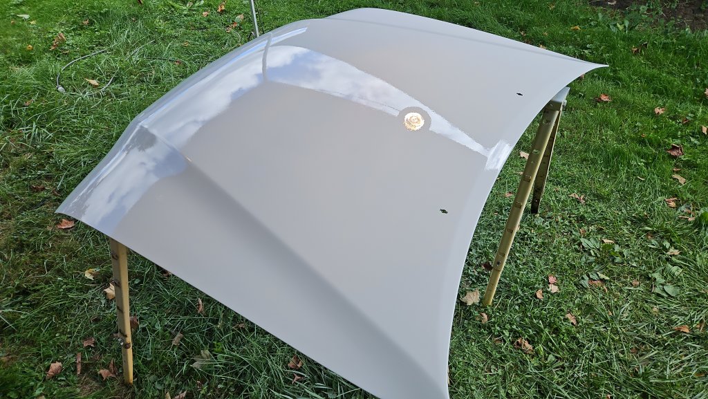

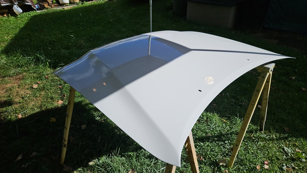

In the early spring, IF you get the right day, the bugs are usually not an issue.
There are some decent pop-up style dining flys for outdoor activities/camping.
I used one to do my first shoot last fall.
This is a doner hood for my ol'Taco.
I shot the primer one day and took a day to hand sand then shot color and clear then next. I never did cut or buff it.
The biggest mistake I made was I did not put plastic/tarp down on the grass. I noticed as I worked around the hood, I kicked up little "no-see-ems" from the grass. Lesson learned.
For my first shoot, I was so tickled and my friends think it looks very good.
It doesn't have to be perfect.
