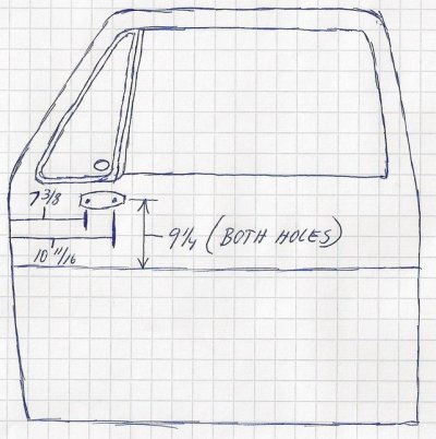

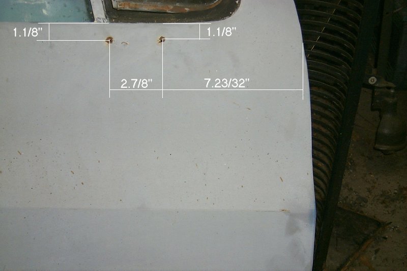

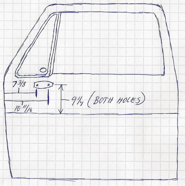

Have a 1987 c-10 that i bought with doors and mirrors shaved would like to install the sport mirrors but cant seem to know where to drill the 2 holes anybody have any measurements as to where to drill the holes thanks…
When I went through this, these are the responses I got. I used them as an approximation.
