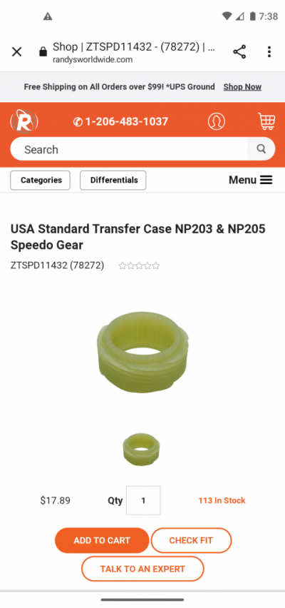

Probably a partially worn speedo gear, inside the tail shaft. It's plastic and wears out. Could also be worn at the other gear that enter from the side.
