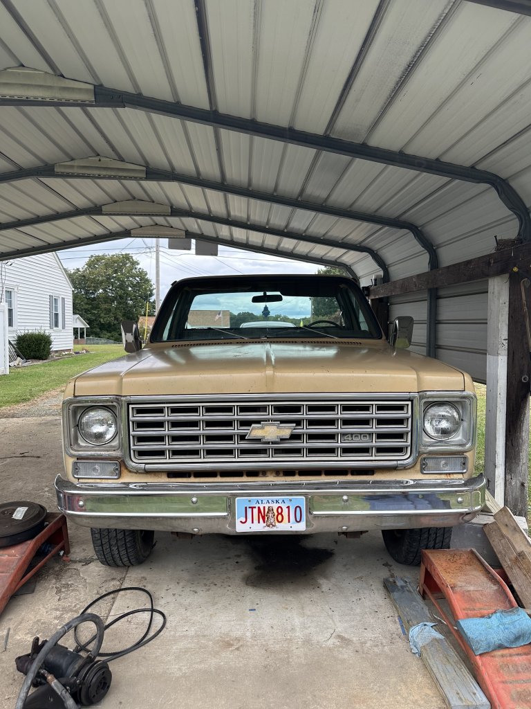

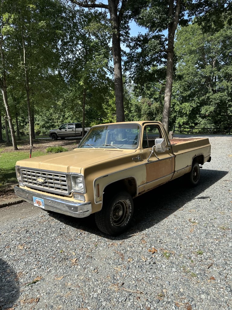

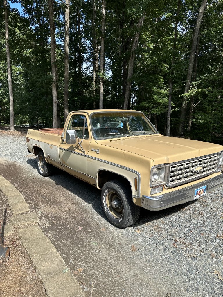

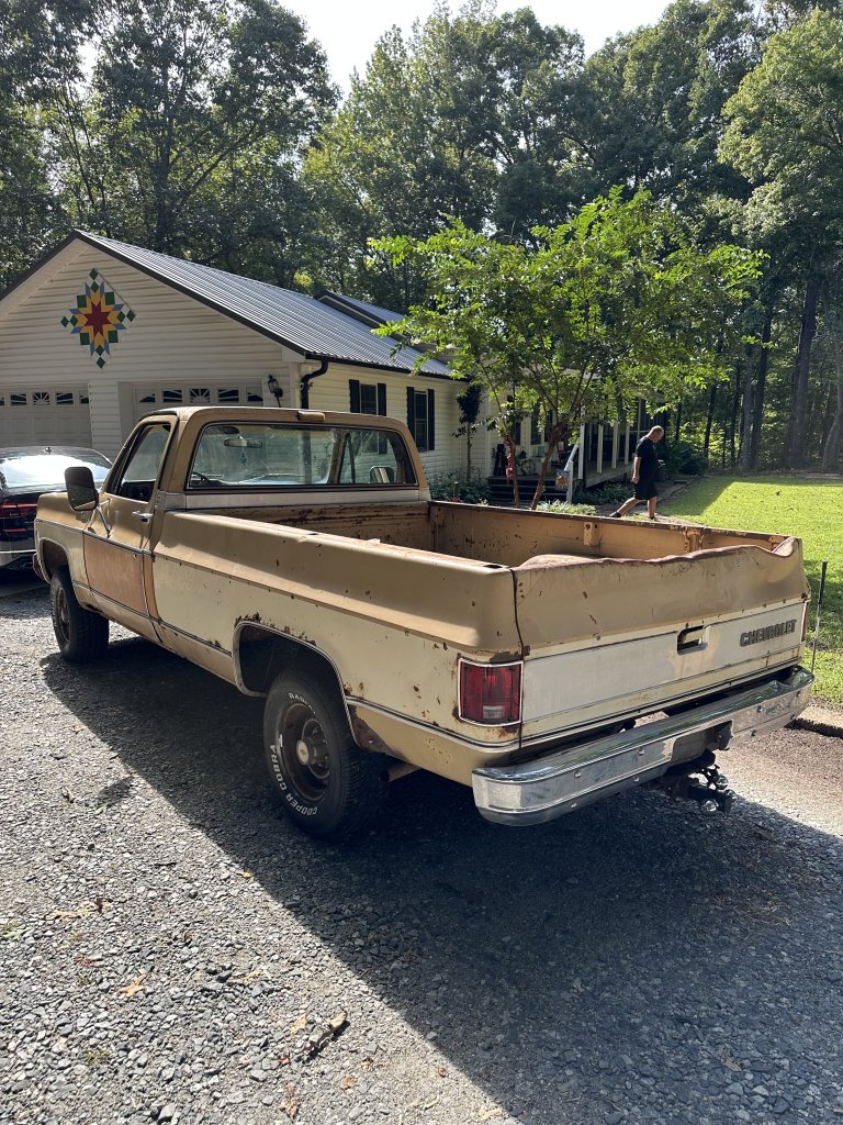

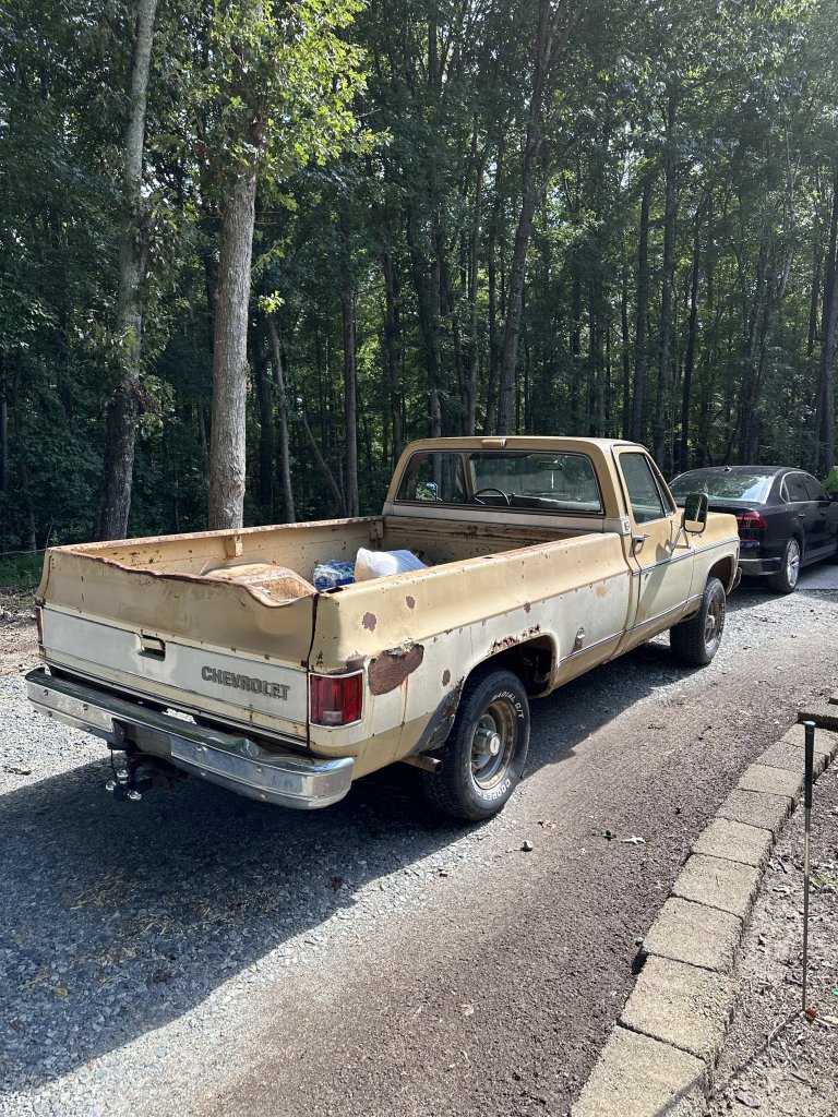

Here she is, I’ve spent the day messing. A neighbor had a known good distributer so I’ve replaced all the components people have suggested. I also poured a bit of good fuel down the carburetor still with no luck. I appreciate everyone’s suggestions so far.

Holy crap she's beautiful! :leghump:
Ya know who would like to work on the paint? @jjester6000 has good ideas and that certainly no reason to hoard teh pix yo. That's a great truck!
Nice pix. :waytogo:

I don’t mind. I’m actually quite proud of the truck, my great grandfather and grandpa bought the same model and color trucks on separate trips to the dealership back in 76, my pawpaw said his was $7100. @Rusty Nail I wouldn’t mind some tips on the sprucing up the paint as I’m not quite ready to give up on the factory colors yet.
