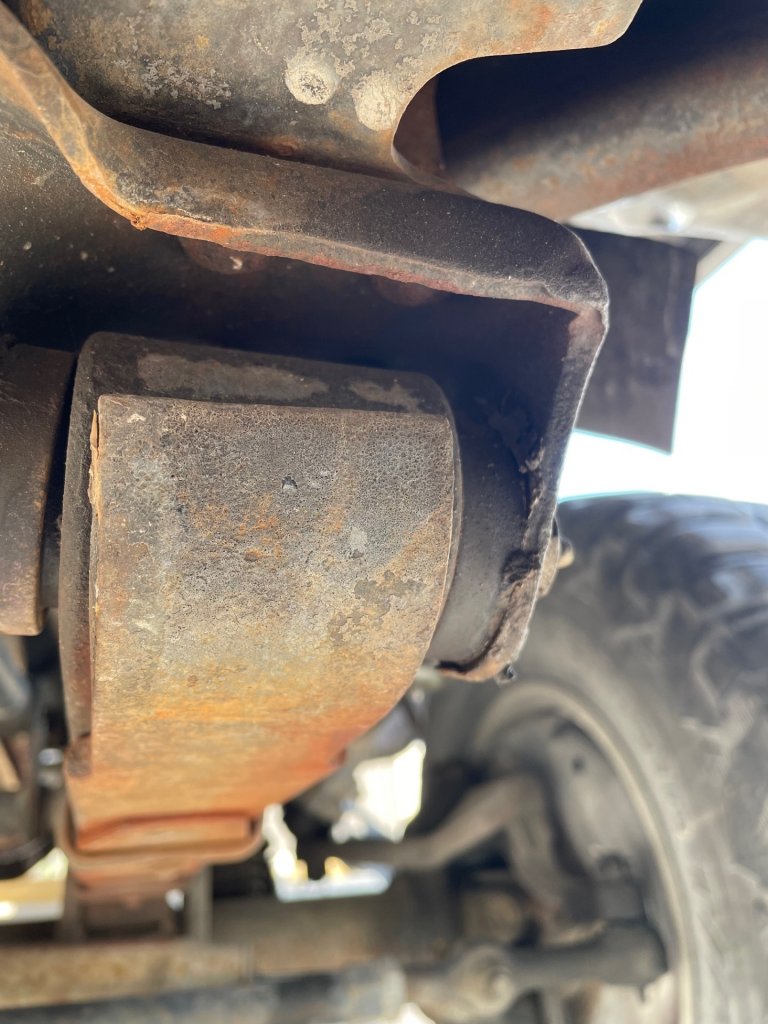

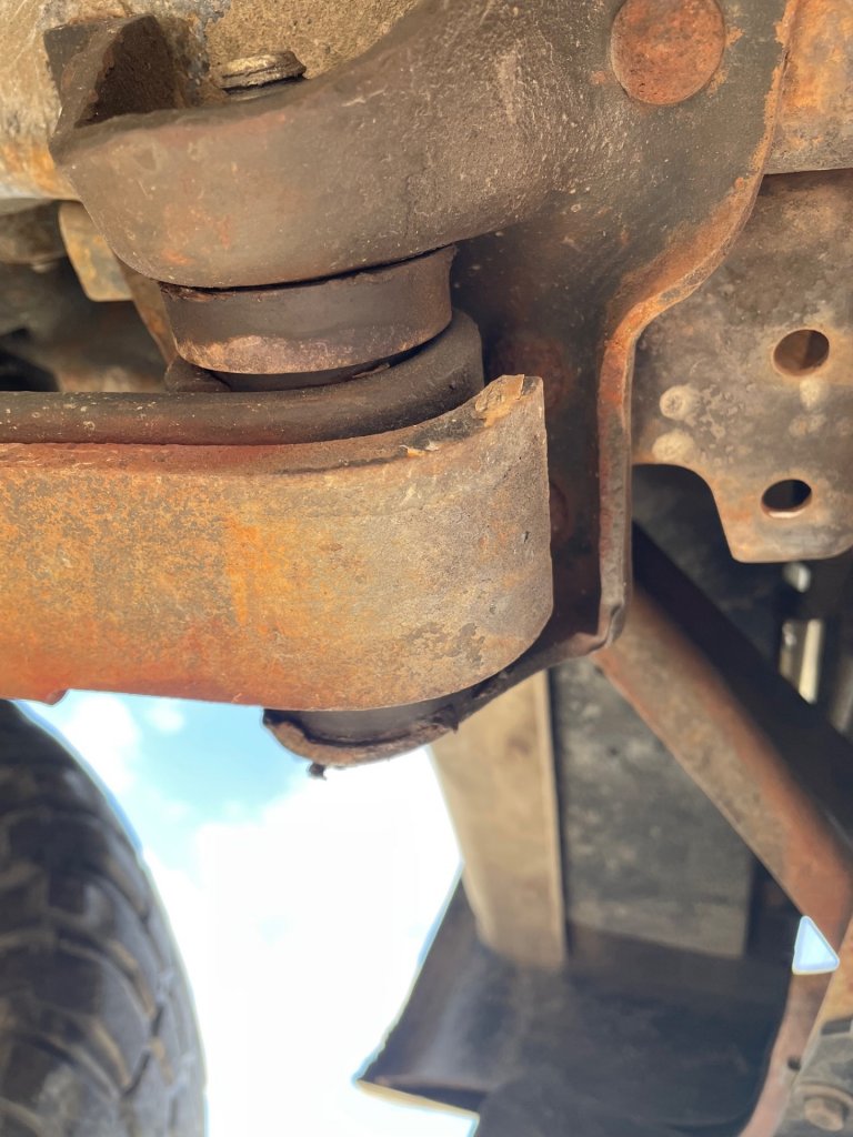

Definitely an aftermarket lift spring, although I'm not sure of the brand. Poly bushings are a bit worn, but it looks like you have geasable bolts/sleeves.
Yes I installed the bushings and bolts.

One note here for posterity: spring eye bolts on these trucks have sleeves in them and the bolts should be kept tight.
