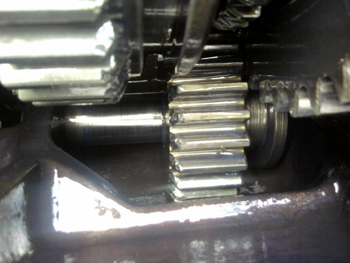

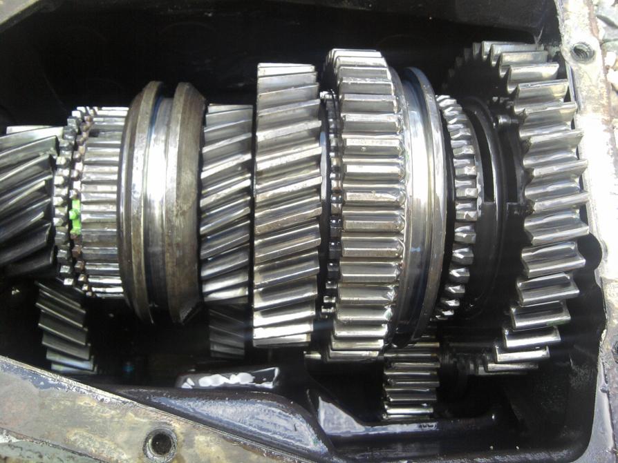

Well yesterday the trans went out. Nothing in any of the gears. It is now pulled apart, but i don't know what to look for. The only thing i see wrong is that i can wiggle the input shaft. i'll see if i can post a picture.
Sachmo
Jul 24, 2012
38
Mishawaka Indiana
Tyler
k20
350/sm465
Anything seem out of the ordinary? the picture of the smaller gear at the bottom of the tranny makes noise if i spin it.
