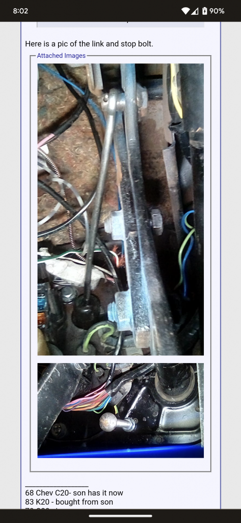

I have the slave from the 94' trans and was contemplating even using the master from the same truck (just new) and I do appreciate the pics. I did find a pic from another forum but the master rod angle looks lightly concerning. Granted I've always done mechanical so when the rod is off at an angle to push straight it just doesn't look right to me

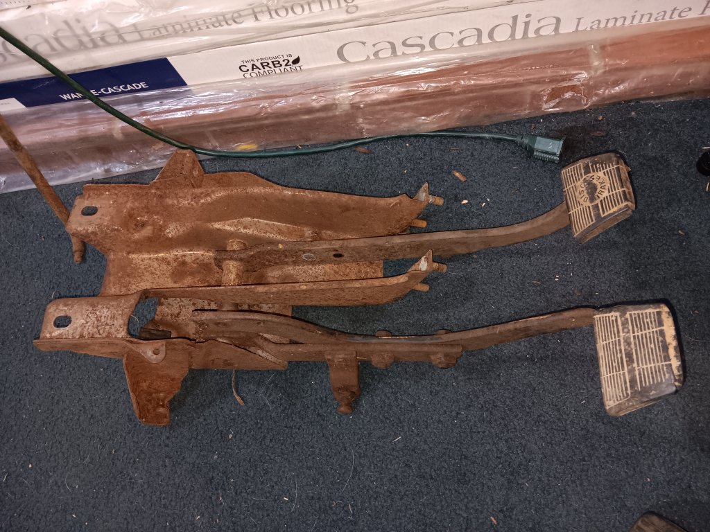

The chevy master sits crooked in the firewall. On my 91 with factory Hydraulic clutch I made a special bracket to use the Ford clutch master because I have a zf5 behind my Cummins. However m interested in this thread because I am possibly this summer going to try putting an NV4500 in my 78 and needing to do a Hydraulic pedal conversion from auto. I have transmission and mechanical clutch pedal assembly to get me started

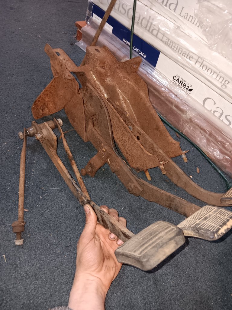

I converted my 85 from a th400 to a nv4500 recently using all factory parts except for an AA bellhousing. Upgraded to hydroboost in the process. I highly modified my pedal assembly with stainless steel oversized pins and spherical bearings/rod ends to forever get rid of the thin plastic bushings and rusty cross pins. I have several OEM clutch pedal assemblies both vac and hydro.
I'm interested in the difference between the earlier mechanical pedal assembly and the 85-87 hydraulic units. Perhaps you could both a few views of your mech assembly for comparison. We should be able to figure this out. I'm also willing to let go of some of my parts if need be.
EDIT: looking at the threads on here about this same topic, I can see several pics of the earlier Z-bar type pedals. I highly doubt it would be worth the effort to modify them to make them work with the later factory style hydraulic clutch. The geometry looks way off, there's no support rods and the push rod goes thru the firewall below the steering column. The dimples the OP mentioned are curious as there was no hydraulic master cylinder until 85. My truck did have the dimples so it was easy to locate and mount the master cylinder (clutch master).

I'll see about getting some pictures of some of my parts in the near future

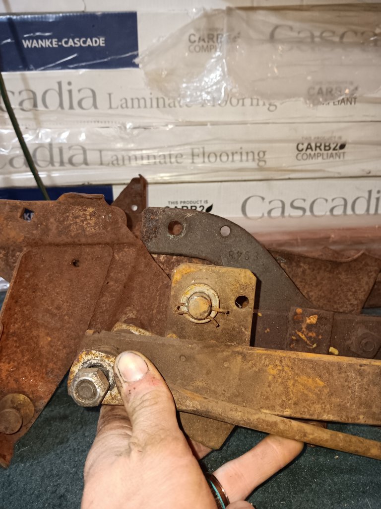

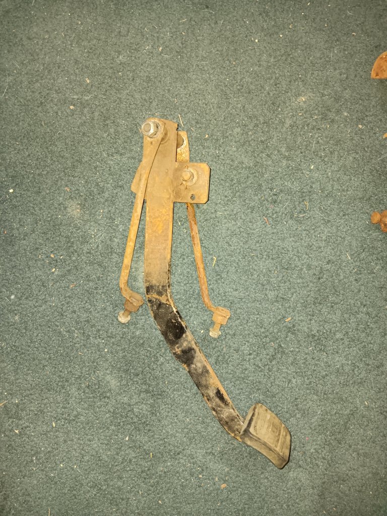

Sorry its been a few days. Heres what i dug up. The pedal by itself in my hand is the Hydraulic pedal. It appears it would fit into mechanical assembly just fine.

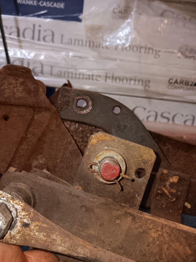

A couple more showing placement of rod side by side marked in red
