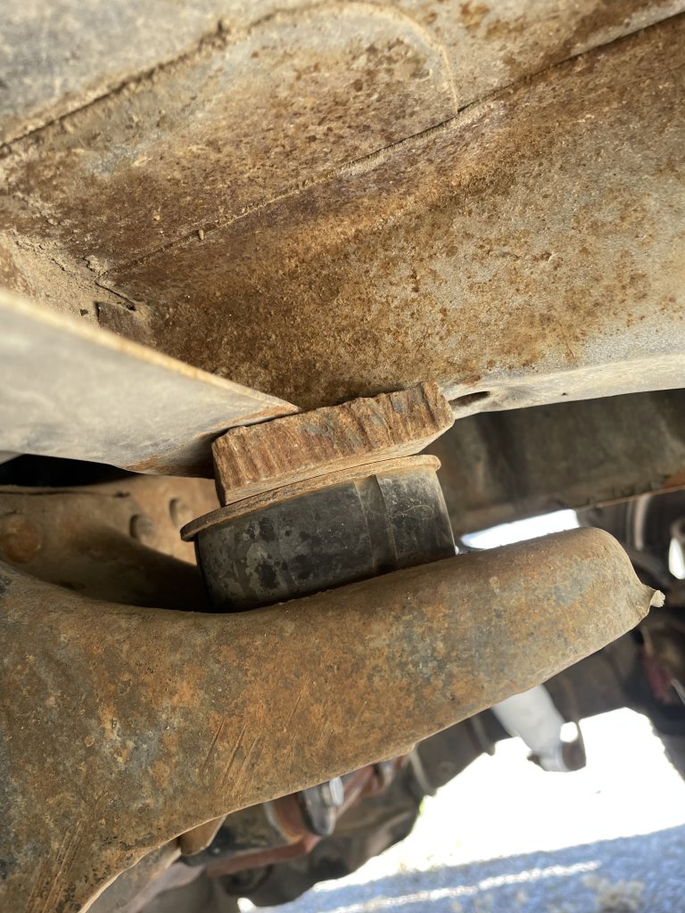

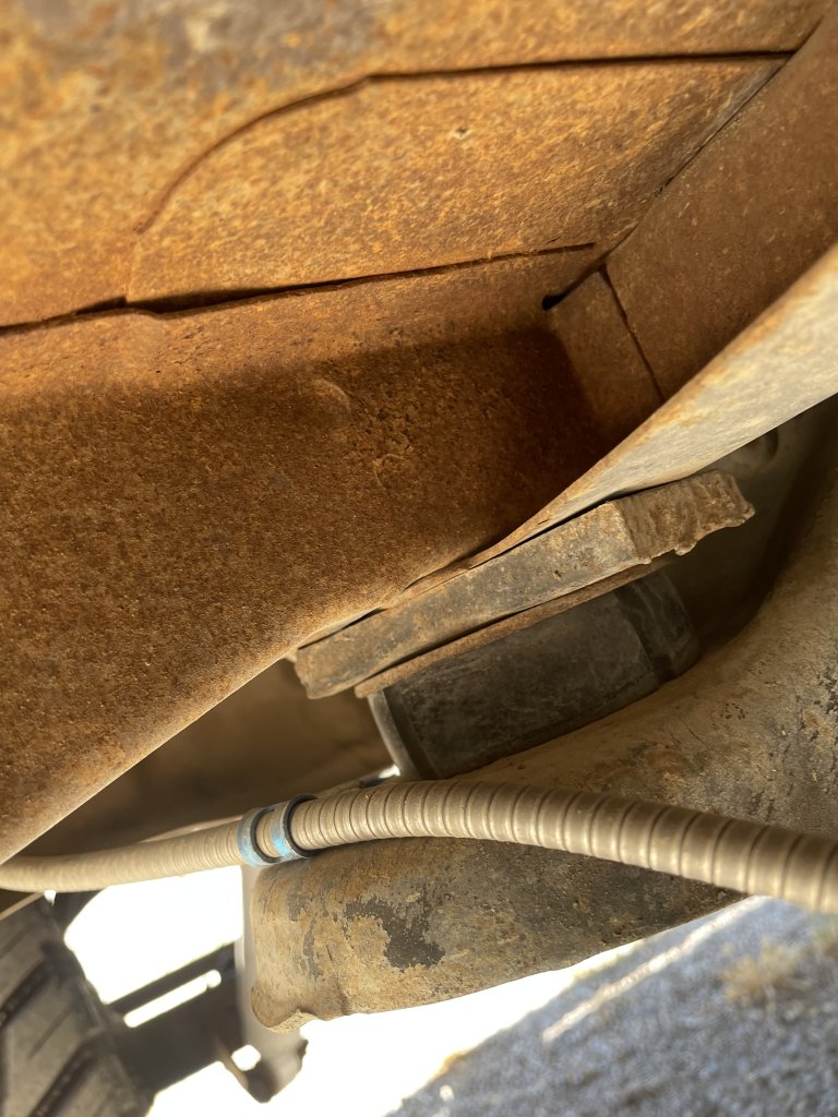

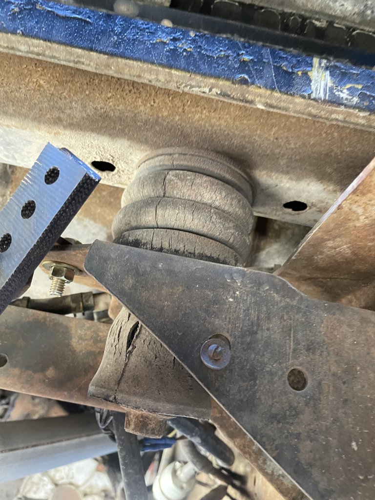

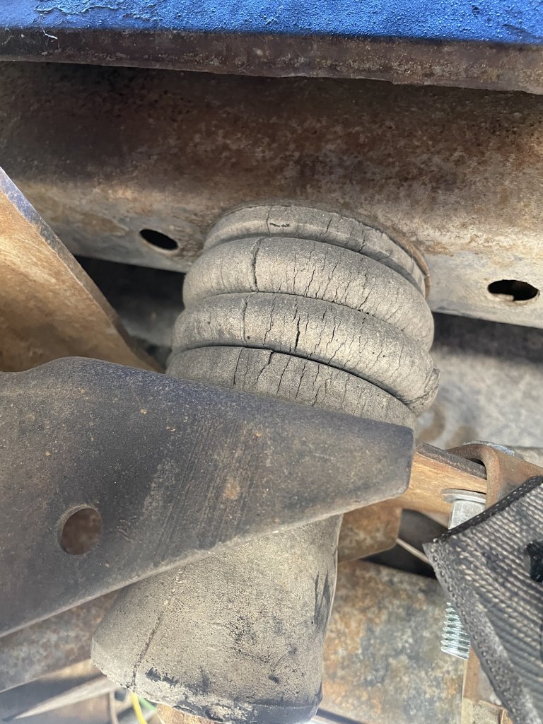

here’s what the cab mounts look like. i’m not sure why there’s metal cutouts stacked on top of the front cab mounts. any ideas?

Bad cab mounts can cause a misalignment too.
True. It can really mess up the cab/bed transition too. I have this problem.
I was under the impression that this just recently started, after having someone service the transfer case.
But at this stage of a squares life, it's time to consider changing the bushings out, using the reasoning behind replacing all the period rubber fuel lines. Those blocks on your front cab mounts looks like someone's idea of "fixed". The original mounts must be ate up some to stuff blocks of steel as shims.
On edit - it occurs to me that if the tone changes by pulling on the shifter slightly, it could be as simple as misalignment of the linkage, pulling on the fork when it shouldn't be exerting any pressure.
31,897
32,700
Yeah, those front cab mounts are probably not helping the clutch linkage.
i should be able to just get replacements and replace them one at a time right?
31,897
32,700
You will want to change all of them, but yeah. Replace them all on one side of the truck, then leave the bolts loose, jack up the other side of the cab and replace those mounts too. Then tighten them all up.
Of course it's not an urgent repair right now either. Just clearancing the clutch rod hole may be enough to fix what you were already trying to fix.
