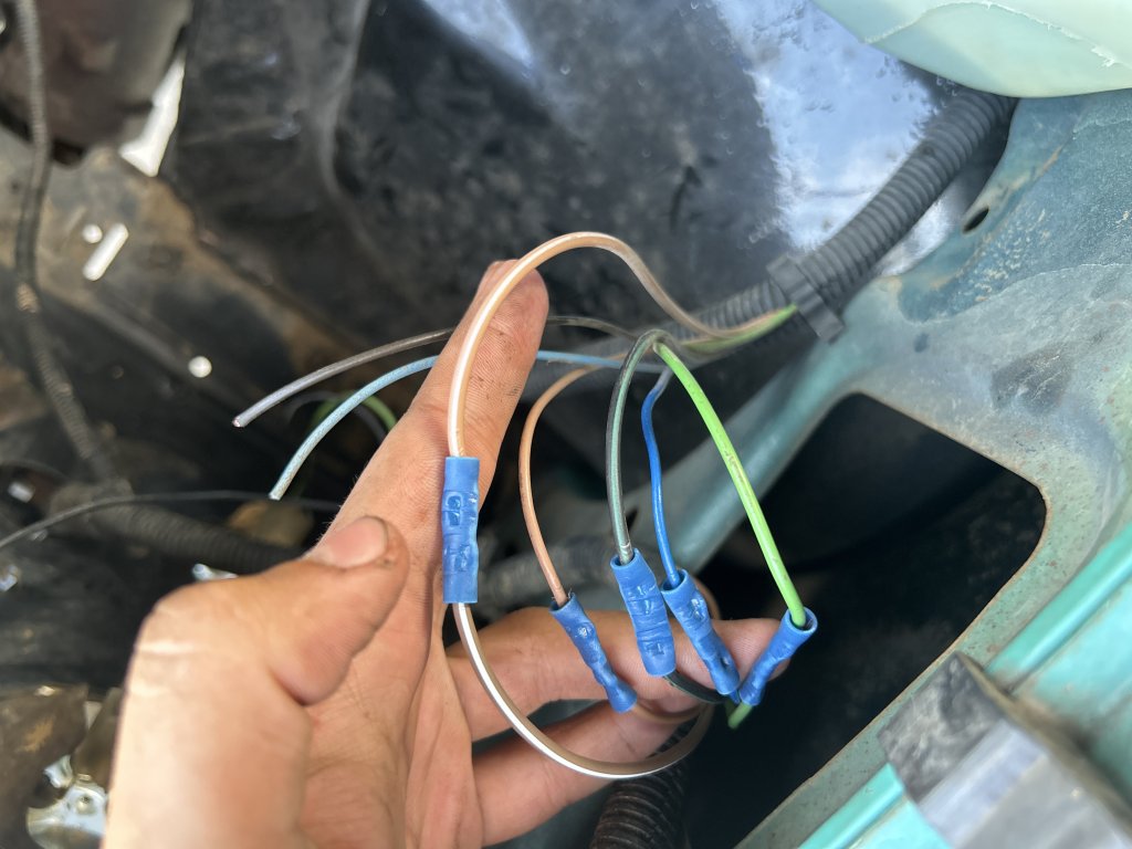

Hi I just put duals in my k5 and I need some electrical help. There is two extra wires and I don’t know what they for…
The parking lights don’t work and horn don’t work everything else seems to be good.

One is likely a ground (the brown one) test it with test light , multimeter or I recommend getting a power probe
