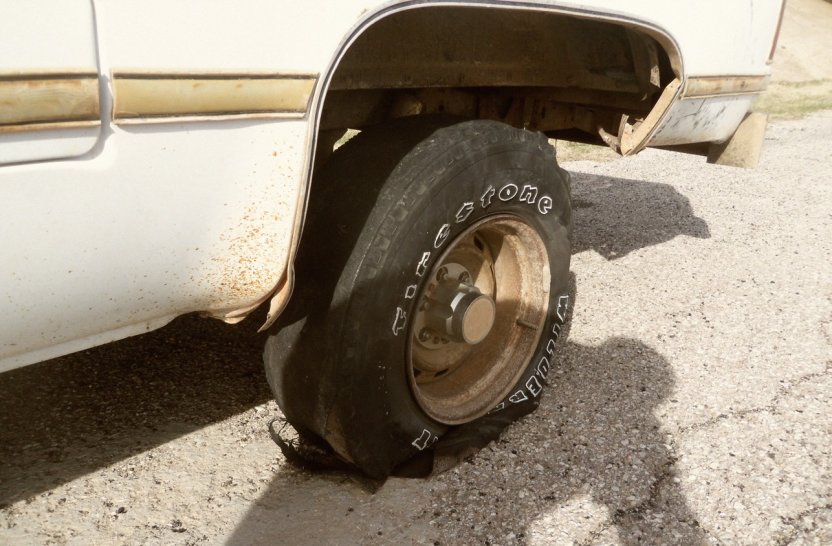

I think I'd keep the same bedside and just find someone that will cut that corner section off and spot weld it in and finish it. That's how I intend to fix my bed that got damaged from a tire blow out. That will also correct the worst rust spot on this truck too.
