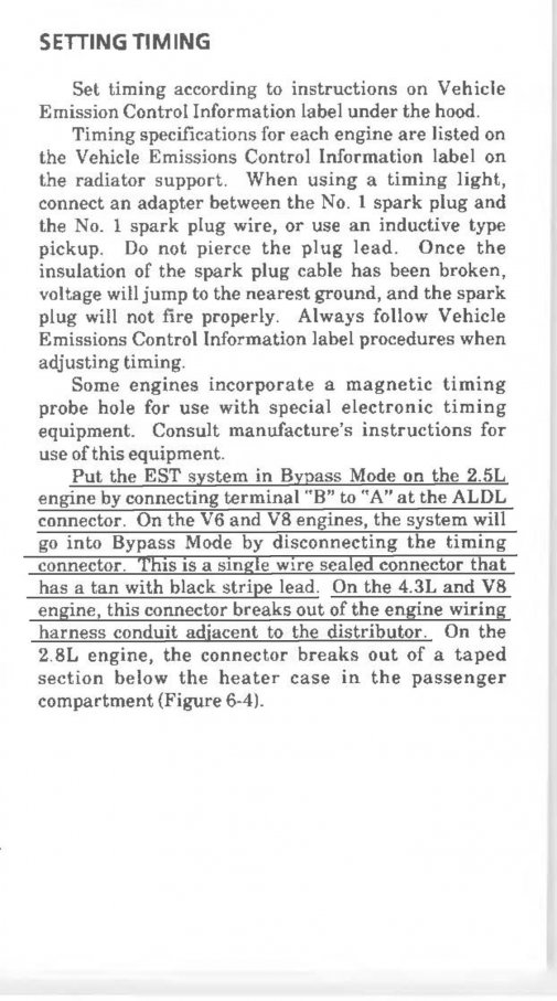

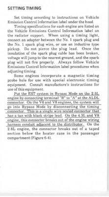

Set timing 1987
From the 1987 Emissions and Driveability manual:
attachment.php

That's what we're looking for !!! :waytogo:

IIRC, the connector is on the driver side of the firewall. Forget the stupid factory timing spec, the engines like 8* BTDC much better than 0*.

Yes, drivers side near the brake booster. Single tan wire with black stripe and a a weather pack connector. May have a pinch of black tape around it holding it to the main harness. Set timing to 0 degrees, which is the bottom of the deepest notch in the timing tab.
